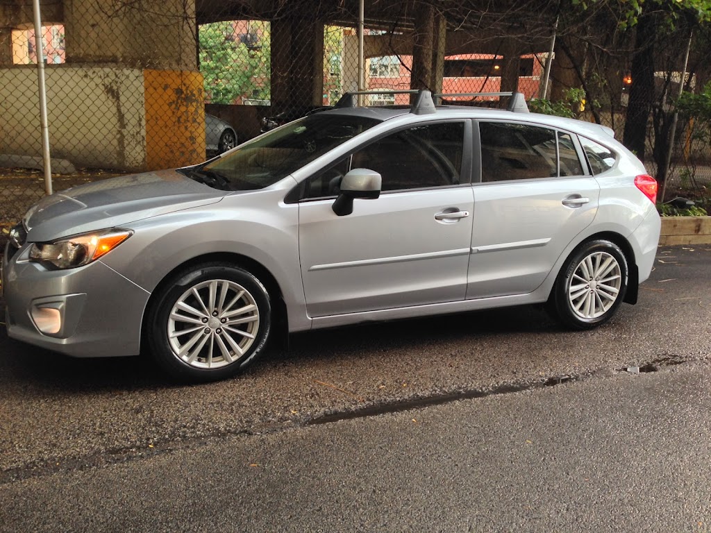

I used the paranoid fabrications spacers on 2012 and it was a very easy install. I used 1" rear, 1/4" front, and it till me a total of 1.5 hours. The fronts probably took me 20min because I didn't have to remove the wheels, struts, etc. Very happy with the look. Combined with my 215/55/17 Pirelli P7's, I got 1.66" lift rear, and .91 front.
