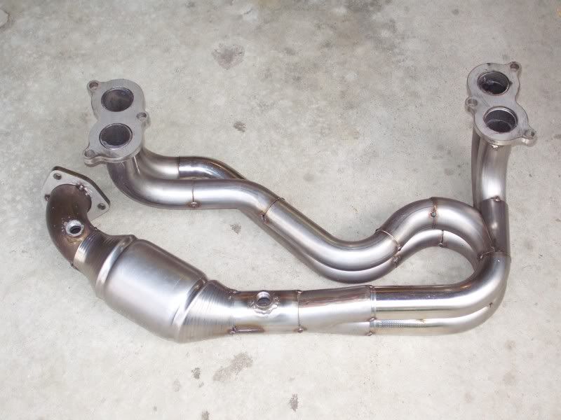

Some quick photos of the finished prototype is a 4-2-1 technically and the layout flows well! This design was chosen because it makes more sense than other the typical UEL on the market.
1 5/8" primaries and 1 3/4" secondaries, 2 1/4" final diameter. Will bolt directly to the 2.5i cat/mid pipe and retains the stock O2 locations. The material is full S304. Catalytic converters are MagnaFlow ceramic double dipped combs (same as OEM) and all bends are mandrel not stretch. Ports are gasket matched and fit over or past the lower driver side engine mount!
The more juicy info is that a few lucky folks will get the pre-production units ahead of the final production units! This will help ease demand and get these in the hands of owners to test and talk.

They do look very nice next order of business is some dyno number to show equal or slight gains over stock to silence all the hater that haven't chimed in on this thread yet

Could be a possibility! 409 is a cheaper option than 304 and it is perfect for Swaintech or JetHot

That is the whole purpose to give the 2.5i owner a bolt on solution

This. They're going to scavenge poorly and those aren't real collectors. With the old style headers, the stockers were so bad that they'd still be an improvement. With the new style headers, it's a toss up.
Buy them for the sound, not the performance.
Cool lookin though.

Well, most of them are bad for your car and all of them don't add enough power to justify $200.
