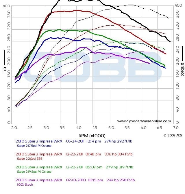

COBB Tuned - 336whp/384tq @ 20psi (e85) & 279whp/319tq @ 19.5psi (91oct) - Mustang Dyno

PREVIOUS DYNO VID
stock pull was 92oct

COBB Tuned - May 24th, 2011 @ 274/292 17.5psi/91oct

COBB Tuned - December 22nd, 2011 @ 279/319 19.5psi/91oct & 336/384 20psi/e85

hmm... 20g xt-r, dom 1.5xt-r, green HTA, or more.. like a dom2.5, 3, or a "small" rotated set up.... maybe just keep the '52 and save for whatever...
this has been the battle for the last 6 months or so while reading experiences and overlapping charts..
i don't want to buy too small and be disappointed or buy too big and not enjoy driving it daily anymore. basically and ideally, i'd like to keep the save torque and hp curve and just have the lines keep going up and top out accordingly on the right. like if you looked at my 4 dyno plots, continue that trend up.
the BLACK line is not a real plot... but that's kinda what i'm dreaming of. smoother lines of course. and suuureee, i'd be happy with more low end or more in general =P soo.. is that possible?
