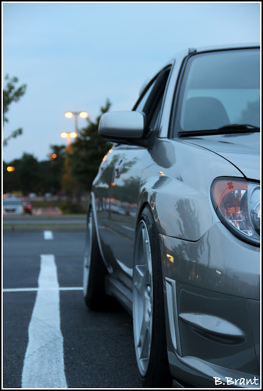

i know about the RPF-1s but ...what wheels are those in the other pics.. i know they are oem for another car but i can't think of what. Info would be much appreciated
correct, they are OEM wheels from a corvette c5!

i knew those wheels looked familiar! im actually surprised they fit. considering how wide the rear wheels are on those things..
