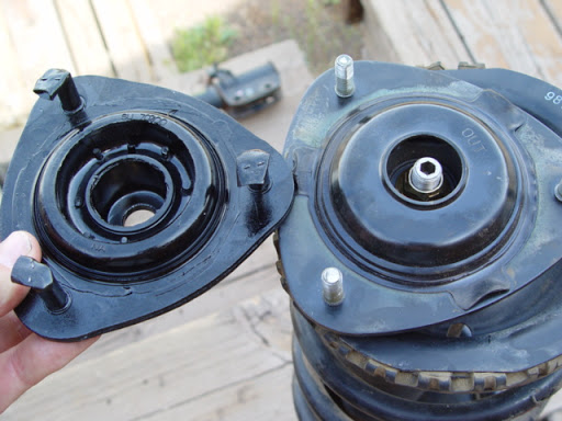

Rear top hats are an issue for 93-01 Imprezas (02-07 Imprezas match up with 03-08 Foresters)
There are two options:
1) Install your stock 93-01 Impreza rear top hats onto the Forester struts. This MAY require some sort of washer/spacer between the top hat and strut (more information required)
2) Keep the Forester top hats, drill a new 3rd hole into your chassis to fit those mounts. This has a couple of issues, including the fact the center of the top hat runs into the strut top hole as they don't match up, and the Forester top hats DO increase the ride height in the rear some more. (I corrected this with a 1/4" spacer in the rear, and a 3/8" spacer up front)

02-03 wrx rear tophats are different from 04-07 wrx rear tophats.
ben_art is offline   Reply With Quote

When I lifted a 93 IMP on 99 FOR struts, I had to use the IMp rear top hats as the early IMP top hat bolt spacing was smaller than the FOR and OB (later IMPs and WRXs are like the OBs and FORs)
I need a comprehensive list of tophats!
Ya, definitely need to compile a list of tophats for this.

If you swap in 02-07 rear tophats into an older car the holes should really be slotted instead of a new hole added. Without the use of a spacer back there and with only one new hole drilled the tophat will not fit.
Something like this.
I'm not sure I feel comfortable recommending people to modify ALL three bolt holes on each side... That makes it 3x more likely for a novice to permanently ruin their chassis.
Drilling one hole was somewhat difficult enough, but I understand why the slotting make sense, since it keeps the tophat centered and supported by the "hub-centric" type hole.
Originally Posted by Jard View Post
If you have 02 -03 style rear struts, you need the TiC spacer to run the GC rear tops.
Does that apply to Forester struts as well?
I need more info on this for sure.
I would need to see the bare tops of the strut pistons to know for sure. I can't see many pics at work either.
If they look like an 02 - 03 strut with the shoulder on top, then yes. If they look like a GC or 04 - 07 strut, then no.
It appears to me from your picture above comparing the "GC8" strut to the "FXT" strut, that they are 04 - 07 style pistons, so you should not need the TiC strut top spacer to run the GC rear spring perch and top. IMHO...
I would use the washer that you normally get with Group-N tops under that top nut that holds everything together...
Washer for rear top hats, part #: 031012000
the 02-03 top hats are shaped like triangles
the 04-07 top hats are shaped like D
both have the same bolt spacing and same sized studs.
So they actually have the same bolt pattern?
The 04-07 D shaped tophats are the same as the 03-08 Forester tophats, I know that for sure.

Yes, all GD WRX (02 - 07) rear tops have the same bolt pattern.
same bolt pattern or same shape? or both?

Both. Check out the first pic in the thread.
