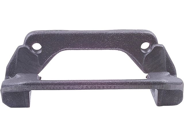

Does anyone know what's needed to run WRX front brake rotors? Can I get away with just WRX caliper brackets or do I need the whole caliper?

The rears are the same. In the front, the WRX Rotors are 18mm larger.

WRX has the same calipers....
You need the caliper bracket.

So just these for the right and for the left?
Seems too easy.

Yes, you need those and the wrx rotors of course. The Wrx models use the same caliper as us.
