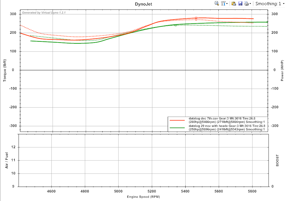

My Dyno Chart with and without the Agency Power Equal Length header on the same tune. Here's some info you guys will probably be interested in. There is a difference of 9hp and nearly no ft-lbs torque but the torque curve is moved to the top end more.
These were done with virtual dyno which seems slightly conservative.
Just header swap no tune:
This one is just the difference in tuning since the header has been put on. I've still got a little bit left to go.
Here's the datalog run I just did tonight with some extra timing and boost added in put up against the old header. The two runs are from before the header was put on to what it is now after 2 tunes.
Here's the difference between my final Custom tune on the Stock Turbo and where I'm at now on the TD05 18g 93oct with an almost finished tune. Keep in mind Ray did an airboy dyno run and this same run on the TD04 he (generously) estimated at near 250hp.
This is the earliest datalog dyno I have recorded vs where I'm at now. This is past Cobb Stage II but only halfway through ray's custom Tune on the Stock Turbo.
Based on the airboy dyno and guestimation, I'd say I'm almost 100hp more than the Cobb stage II tune both running 93 oct.
