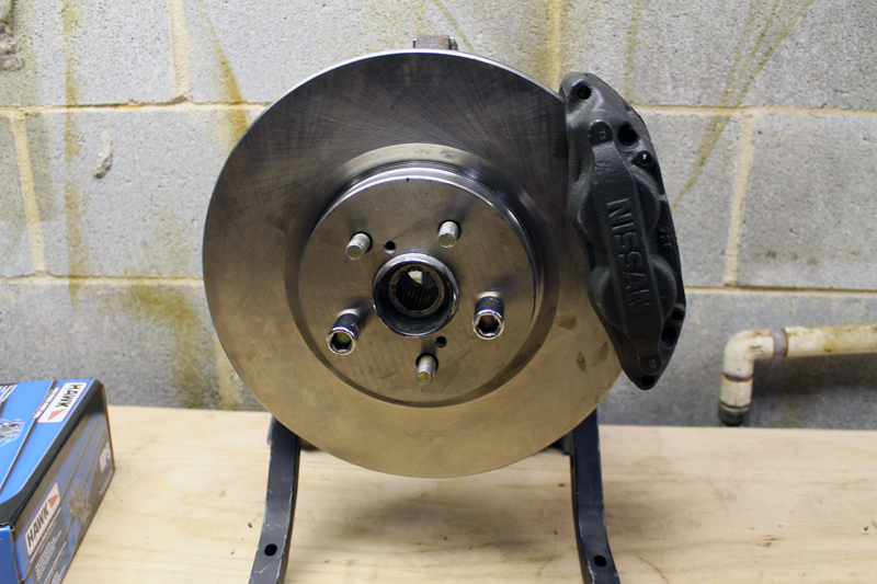

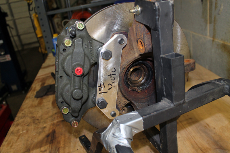

Bracket bolts on an older knuckle just fine (press in bearing)
I raised the points a bit too much so the pad sits high - that's an easy fix.
But...
I was looking at a newer knuckle w/ bolt in bearing assemblies. At least on an STi knuckle it will not fit (at all)
Who has a pic of a bolt in new age knuckle? That will require a different bracket I bet.

2010 WRX
Spark Silver
But...
Well the STi does have a larger bearing than the WRX does. So maybe that's just the hang up.

The OG bracket was on my 06 WRX - so I think WRX to 207 is OK.
Pretty sure 2008 WRX has the new bolt in so we'll have to revisit that one.
The LGT....meh who cares
Foresters up to 2008 should be good to go as well.
So - let me get a revision done and we'll make them.
Can we please get a list going?
And can you please at least consider getting the other required parts from me?
-Ken

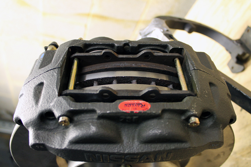

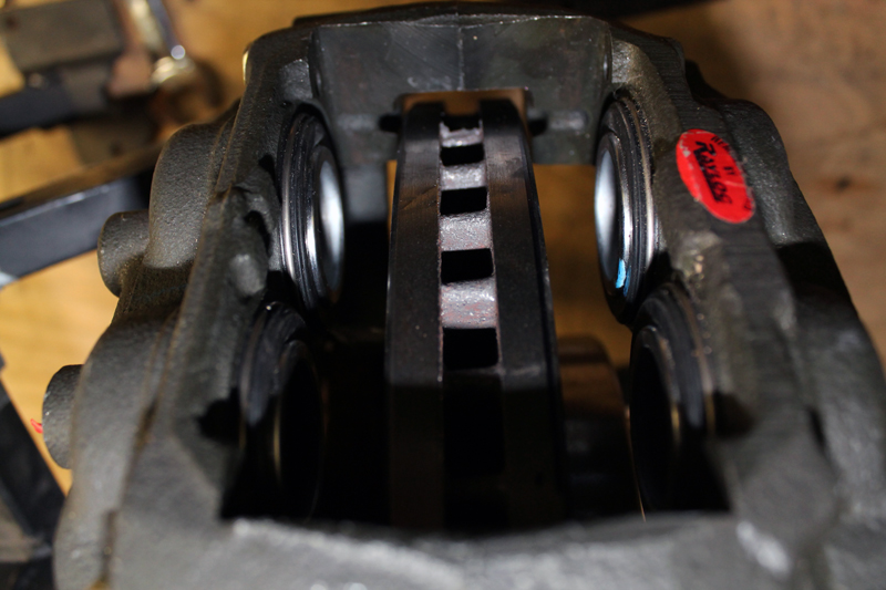

A couple more tweaks need to be done to the prototype!
I have to push the pad down a few mm to get it about 1 mm below the edge of the rotor.
This means we may need to ever so slightly kiss the edge of the rotor channel for clearance. Worth it to get that pad down where it needs to be.
Hardware is easy and readily available
Looking pretty good.
Sending the revised model tonight. He should be able to turn them out quick.
They won't be powdercoated - that is too thick.
