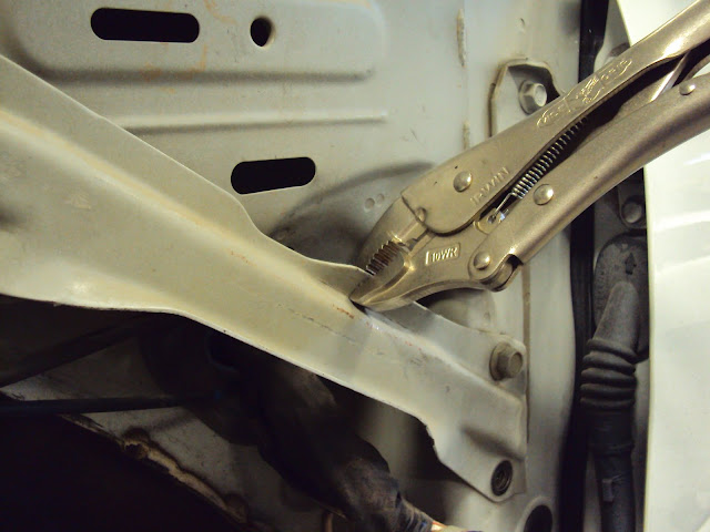

Can you post pictures of where the control arm hits the frame? Having serious issues getting my friends car lower on bags and nothing seems to be hitting so we'd like to see exactly what you're talking about
Here ya go! The camera is basically next to the rotor, this is the driver side front. Follow the control arm from the hub to where it attaches to the subframe, that point is shown in this picture. I made the notch PLENTY big enough, probably could do with 1/2 this size.
Thanks, Damn that's what we cut today, the frame is c-notched at the axles and there's enough gap between the wheel and the top of the tires to fit a finger so we don't need to cut it out at the top of the wheel well but he's still about an inch off the ground. We're running out of ideas lol
How far do you have the struts threaded down? I have mine threaded nearly to the CV boot which is just enough to get the car to lay subframe on flat ground (our shop). Wheels are 18x9.5 with 215/40 Hankook Ventus V12 tires. 17's should be a bit easier.

Had my WRX on the lift this weekend, before notching for the control arm I marked the spot with a paint marker and took a photo to share here
This is the last spot that will prevent a GD/GG from laying subframe.
Legal/Insurance disclaimer: Bag Riders LLC does not recommend chassis modifications - do so at your own risk!
