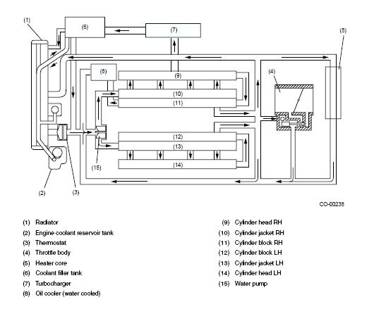

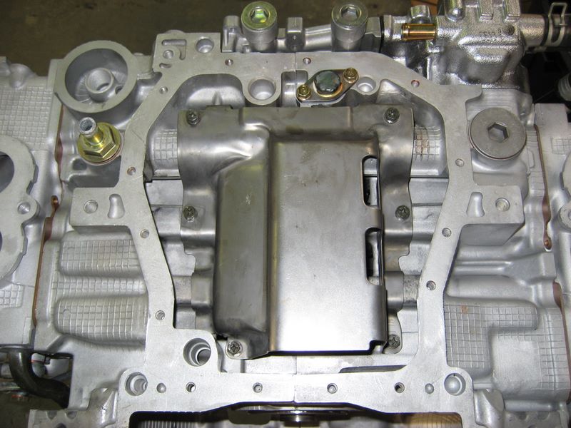

It feeds the oil cooler water.
(Picture from my oil dry sump setup which is why I have capped the oil pickup, DO NOT DO THIS)
It's part of #8 in this diagram.
If you are not planning on running the oil cooler then it can be plugged. Other end (on water pump) needs to be plugged as well.
