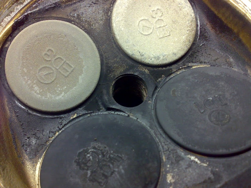

Originally Posted by Clark Turner View Post
Running a V7,V8 or V9 JDM sti engine with the stock file on US Gasoline is a recipe for disaster. In short, Dont do it.
Take it from someone that has been swapping and tuning these setups since 03. You need to retune the ecu properly.
Clark
In support of Clark's post, here is one of things that happens if you do
Hyper is offline   Reply With Quote
