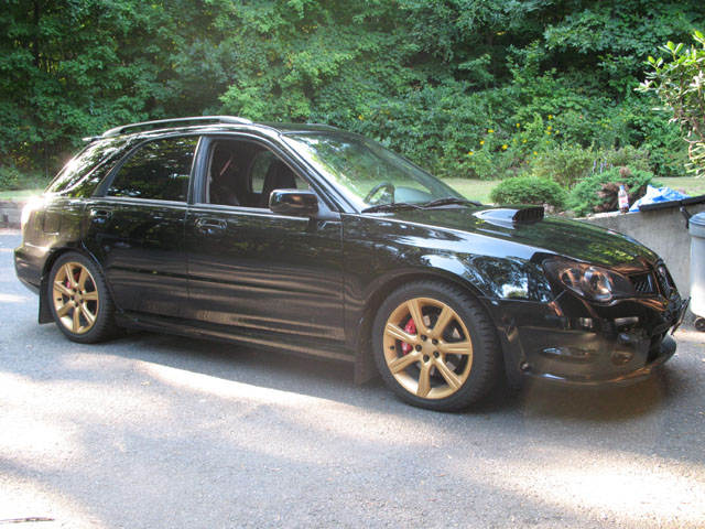

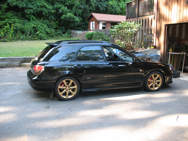

Just did mine on monday:
-Rene
What color paint did u use? Clearcoat? Primer?
AspenItIs is offline   Reply With Quote
Old 09-06-2007, 03:03 PM   #184
Rene2.5RS
Member#: 4574
Join Date: Mar 2001
Location: Wolcott, CT
2011 Legacy 2.5i LMT
Keeping in mind these are only winter wheels I used Color-Place Gold and Color-Place Clearcoat (distributed by wal-mart) the color-place logo resembles dupli-colors but this is all a guess. I have pictures of the cans at home that I can post later.
Started with wheels that only had about 6k miles on them
cleaned
scuffed
cleaned and wiped down
let dry
4 coats of color
3 coats of clear
sun baked for 5 hours
-Rene

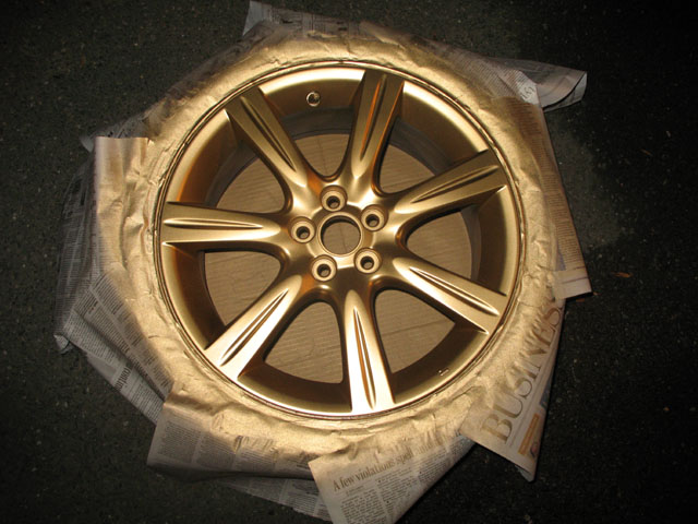

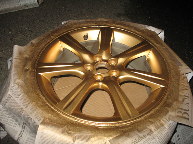

For repairing wheels, I used the toothpaste tube of Bondo and it worked great but I heard good things about Aluminox so I started using that. That stuff is strong!! Once it dries, you can sand, paint and even drill it! It's mostly used to repair holes boats so it's strong stuff. A little harder to work with than Bondo but it's good stuff.
Aluminox
The primer I always use:
The paint I used:
Rustoleum 1936 Metallic Brass:
I've been using SEM Color Coat for my clear coat on most of the wheels I've done but it's so damn expensive. Does anyone else have a high gloss clear coat that they recommend?

Rene2.5RS- Your wheels look awesome. Did you paint your headlights as well? That's a bad ass looking wagon.
Thanks man, yeah I painted the headlights using a semi-gloss black.
