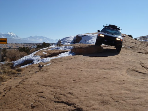

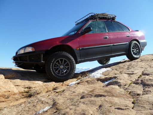

Cannot believe I haven't posted pics in this thread yet. From middle of last year, been down for a while waiting for an altitude adjustment .
front-
rear-
side-

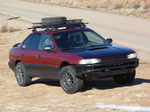

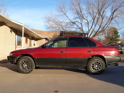

Gone from gen 1 OB to gen 2 OB to '94 SVX front coils
'99 FOR rear spring and 94 SVX front spring in 99 OB KYB GR2s, on 95 legacy
stance is high and tight, despite 140#s of bumper and skidplate!

NICE!! It's the going back up I have a problem with
5MT with 3.90FD and 27" tires = NOT a crawler lol

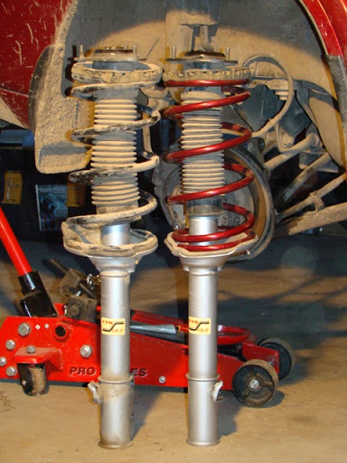

Unfortuately, I didn't add the FOR coil for these front spring comparison... lazyness, sorry
At any rate, here are rear springs from OB and FOR
gen 1 outback (1997) left (sorry, it's actually upside-down) and gen 1 forester (1999) right (painted)
the front is also a little taller than OB coil, but a mm smaller thickness....
so a gen 1 FOR coil will lift a gen 2 legacy/gen 1 OB a little... BUT the FOR front coil has a decreasing diameter, like the SVX shown here, and the OB does not get smaller, so you need the forester upper spring perch to mate to the tophat in front...
