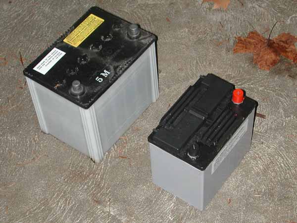

I got the idea from all the talk about the ultra-lightweight drycell, but I wanted something that could make it through the winter. So I ordered the Miata battery from WestCo. It has 475 cold cranking amps and 31 A.H. and is completely sealed. It cost $84.95 including shipping direct from WestCo:
http://www.westcobattery.com/pages/products.asp?id=11
It's a bit smaller:

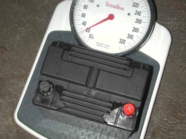

And weighs just 22 lbs:
But contrary to popular myth, the stock battery doesn't weigh 40+ lbs:
Oh, well, I saved 12 lbs ahead of the front wheels. Not too bad for 85 bucks and 20 minutes.

As I pointed out, it would be hard to save 40 lbs when the stock battery only weighs 34. FYI, the Optima battery weighs 38 lbs.
