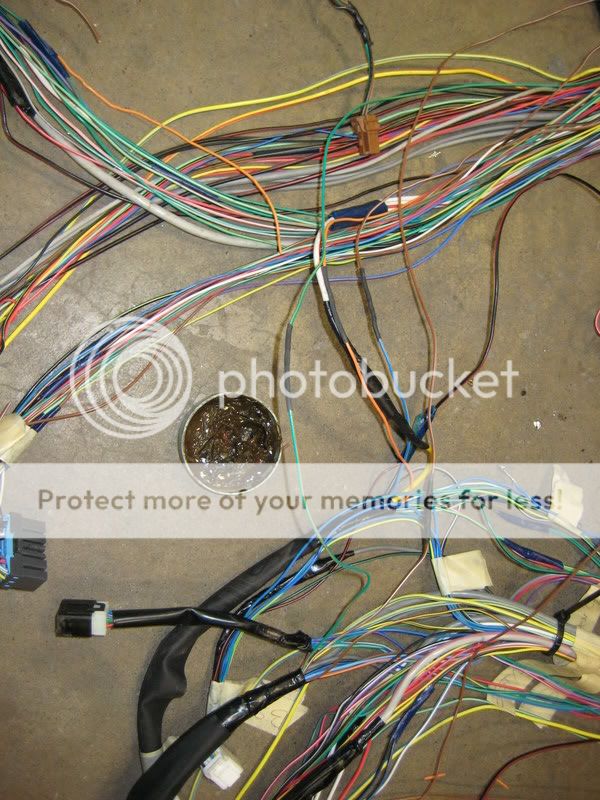

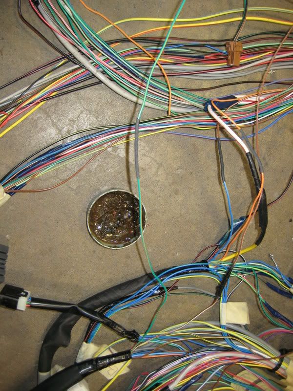

Fuel Tank Pressure Sensor. B136-12(RS) to B15(WRX). The green wire.
Line End Check 2 (goes to OBD2 Check Plug). B135-21(RS) to A20(WRX).
SSM/GST (goes to OBD2 Check Plug). B135-3(RS) to A21(WRX).
Engine Speed (RPM/Output). B134-30(RS) toC9(WRX).

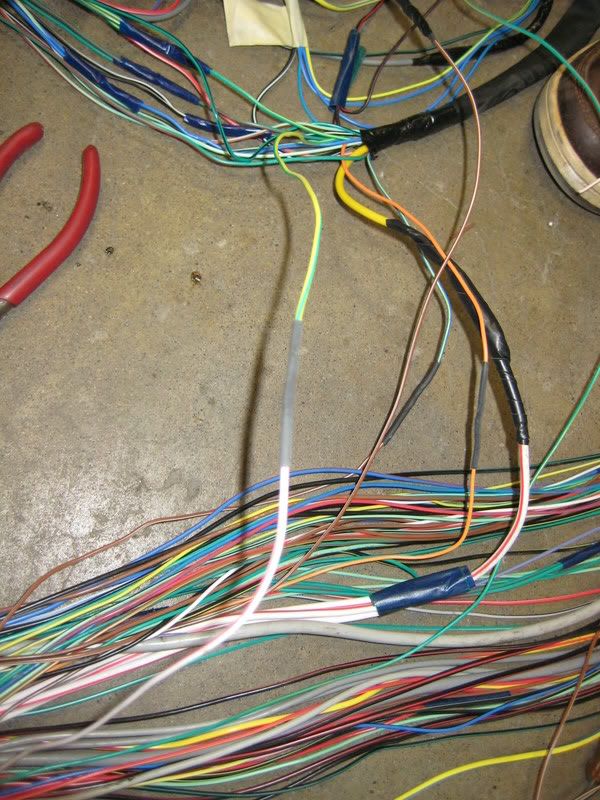

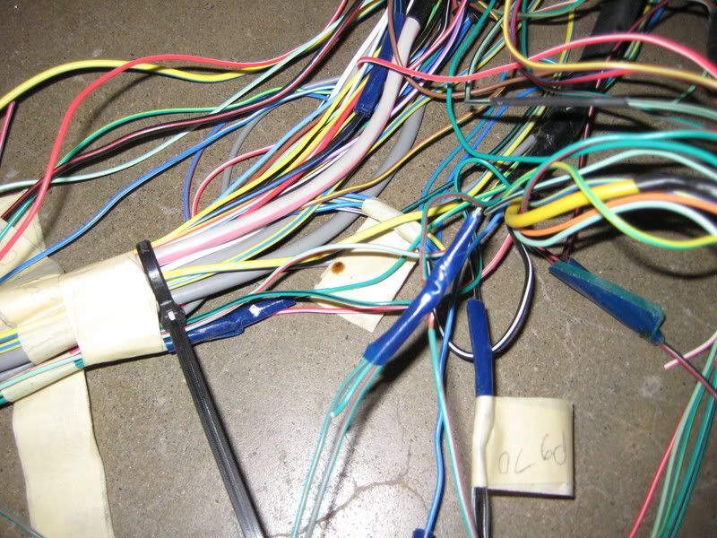

Blower Fan Switch. No position on 99 RS. A9(WRX). The wire spits into 3 places form the WRX ECU. Two go to the HVAC panel controls and the other to the blower motor fan relay. Some random pictures of the wires. Note: I was told by a reliable source that the 2000/01 RS’s have this wire at the ECU.
The 3 wire junction.
Green/red stripe wire.
Wire at HVAC panel.

These are the wires that go behind the heater box. I ran all of my wires in the bulk harness to give it an OEM look. This is probably the main reason why I took the harness out. Note: this stage took my a while to do. The first time I put the AC box in the wires were really tight against the box. I wasn’t happy with the fitment. After un-taping some wires and re-taping them there is now about an inch give on the wires after everything is all bolted up. There is no sense in half-assing this stage after coming so far.
Motor ready to go back in. We drained the tranny fluid so it wouldn’t leak all over the place when the engine was up at an angle.
General picture with nothing hooked up.
