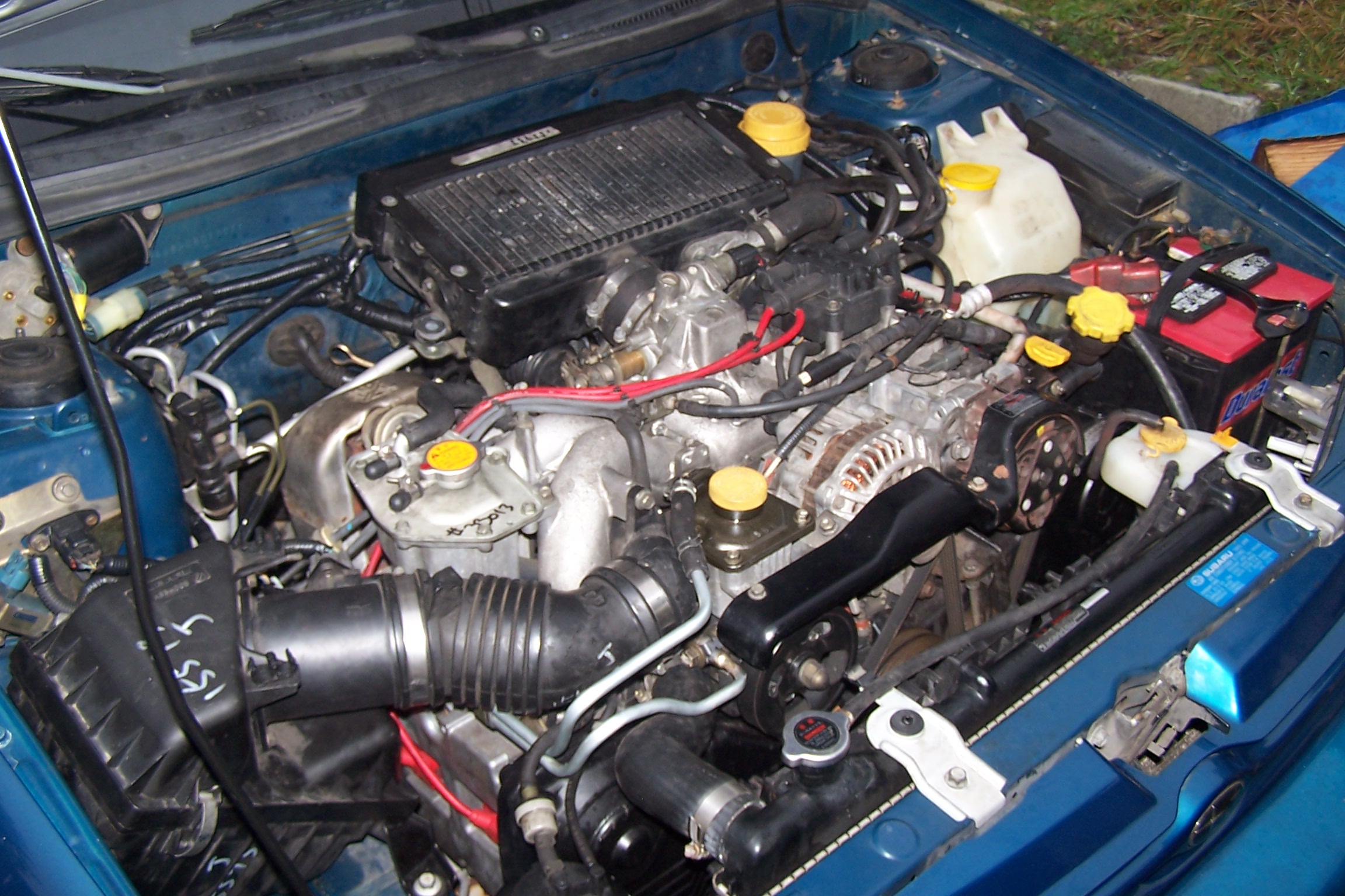

just did a V5 1999 EJ207 swap into a 1993 Impreza L.
went prety easy, had a few hickups but nothing all that bad.
on this one i had to make custom power steering lines. but i was able to keep the AC in working order.
-=Suberdave=-

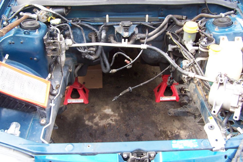

i have the same engine and I will be swapping it in the next few weeks. what did you end up doing for powersteering lines? what all needed to be modded to get the engine in/running. any other hangups?
slidewaysuby is offline   Reply With Quote
Old 01-26-2009, 12:58 AM   #13
suberdave
Member#: 101865
Join Date: Nov 2005
Location: Covington, WA
88 GL-10 STi
silver
i bent my own custom lines from 3/8 brake lines and took them to a A/C guy i know localy and had him silver solder the ends on them...
hi-res pics
Pic one
Pic Two
no other hang-ups other than weather and shipping delays...
