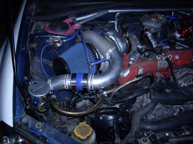

I decided to rebuild my car for strong low 10.xx on street tyres.
this will be street every day car as it was.
I hope this will be one of the fastest WRXs in the Europe (if new turbo will have full boost before 5500 rpm )
weight is expected at a bit low than 3080lb
New to come:
-Axis heads with 280 cams, springs, big valves
-clutch HKS GD max
-6mt DCCD STI 07 with rear dif
-DCCD controller Neetronics
-rear axles DSS 1000hp
-Kartboy shifter STI
-Rota G-Force 17*8
-tyres Nitto 245/45/17 555 Drag
-ECU - HKS Fcon Vpro MY TUNE AS ALWAYS
-HKS knock amp2
-one more Walbro
-HKS fuel controller
-TURBO BorgWarner S374 with race cover (size like GT4202)
-custom twinscroll based on GTspec header
-2 wastegates TIAL 38мм
-blowoff TIAL Q type 50мм
the rest is the same as it was

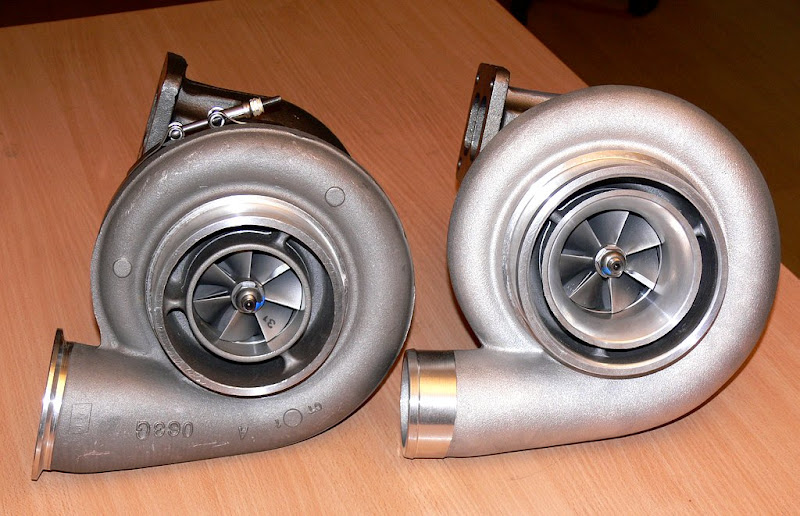

Garett GT30 with my S374:
usual S374 next to RACE COVER S374

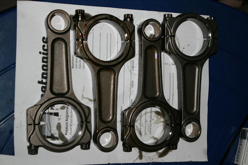

we also disassembled ьн motor to see how it is doing after 36 PSI of boost and measure it
pistons look good
crankshaft as new!!!

turbo is installed

Originally Posted by crashtke View Post
Very cool set up. I have a Sargent Power S362 rotated kit going on a customers car next month. We are very excited to see some results. What RPM does the car spool at with the S372 and the twin scroll?
boost is BW S374 1.0 AR:
3832 - 0,51
4030 - 0,66
4152 - 0,73
4427 - 0,90
4581 - 1,03
4738 - 1,16
4891 - 1,29
5098 - 1,43
5269 - 1,54
5468 - 1,67
5670 - 1,79
5898 - 1,88
6058 - 1.98
6221 - 2.05
6409 - 2.09
6590 - 2.15
6912 - 2.21
8500 - 2.40
