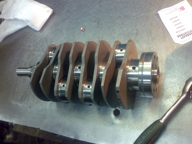

You can always go 83mm stroker crank and make a true 2.2L. It does require some clearance work on the block, much like a 383 stroker in a 350 block.

what clearance work?
we didn't have to do any, using brand new EJ207 block and BC 83mm crank
I love that motor... it's amazing, torquey and revs to the sky

Yum. How much was that crank? Any dyno charts?
Sorry, should have specified that I clearance for the rod big end. I run Pauters.
BC cranks are actually quite 'affordable'...heck, I can get 5 cut to my specs at $1500 each.
