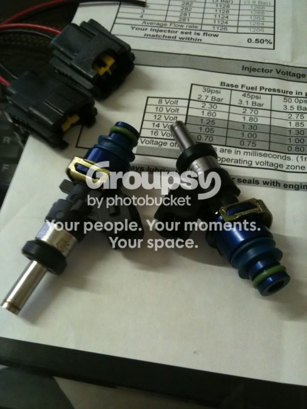

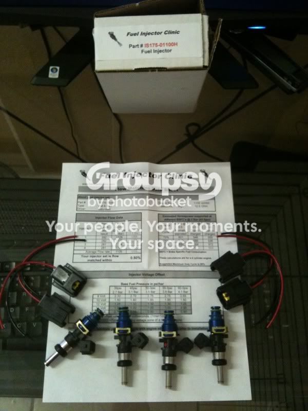

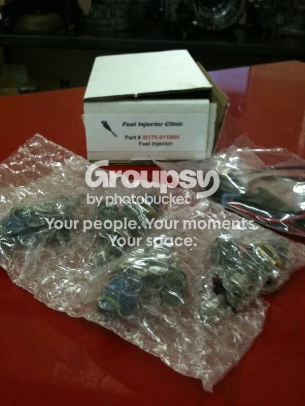

I just received my 1100cc for my car and also got the word that they are out for the public. Here is a brief description:
The Fuel Injector Clinic 1100cc Injector is a saturated / High Impedance Ball & Seat Injector. This 1100cc fuel injector provides great trailing throttle response and minimum pulse widths resulting in a perfect cold start and idle.And, it will work with E85 or other high performance fuels. The FIC 1100cc fuel injector will fit to Jetronic harnesses. (Resistor pack removal recommended when applicable.)
This new Fuel Injector Clinic 1100cc/min @43.5psi (3Bar) high impedance injector is 22 percent larger than FIC’s similar 900cc injector (also called the 1000cc injector by others) when flowed with calibration fluid, n-heptane or similar.
(Approximately 97 percent of fuel injectors sold today are flow tested using calibration fluid, n-heptane or similar allowing for ‘apples to apples’ comparisons when upgrading or purchasing fuel injectors.)
The FIC 1100cc fuel injector fills the gap between the 900/1000cc injector applications and the 2150cc injector application.

Those look like they will poke into the TGV pretty far. Will their nozzles contact anything? I'm curious to see what the spray pattern results in if they are really close to the divider between the two intake runners in the head or the divider on unported (completely) TGV's. (If I'm remembering this correctly.)

are those bosch style clips?

They are Ford style clips. They are true bolt-on injectors but you have to change the electrical connector, included pig tails.
