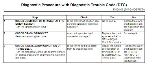

Got a code reader. the car has 2 codes, both the same thing:
P0336 Crankshaft position sensor circuit range/performance problem
what does this mean?
going out to check teeth now..
This is probably exactly what is causing the problem.
Either something is horribly wrong with the timing itself, which from what you've said doesn't seem so, or the cam sensor isn't working correctly. Double-check and make sure it's plugged in at the sensor. If it is, trace the wire all the way back under the intake manifold. It plugs in to the rest of the engine harness somewhere underneath the throttle body. Double-check that it's plugged in here.
If all of that is OK, you may try to swap over a cam sensor from a working car. I don't know if you have another so you may want to pick one up from the dealer.
I'd be interested to have Matt Monson chime in... he has a lot more insight on problems like this than I do.
Good luck!

From my 2008 FSM:

its #2. Found out from rs25 that could be a problem as well. The crank sprocket has a broken tooth. I must have broken that at some point. I hear its about 30 bucks at a dealer so we'll see what happens monday.
Thanks for all the help

car sounds a million times better. More like, well you know, normal.
Except it is still throwing that P0336 code that won't delete. And there is a light sound coming from the driver's side head. not sure what that is. Car revs up as normal. Idles a little rough though

That was the problem. I bought a new one and things have been a lot better except for that noise i just mentioned.
Still has the P0336 code and some sort of noise from the driver's head area
