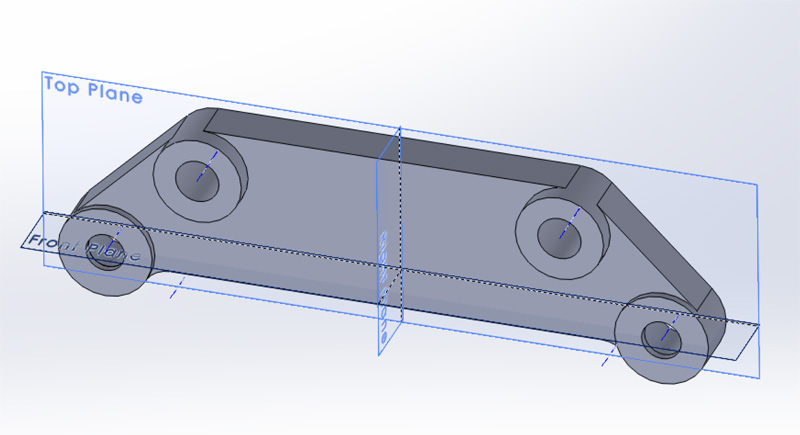

Originally Posted by KNS Brakes View Post
It seems like you are machining a lot of the front of the plate to create a "spacer" effect. It seems like the original part used washers instead of the extra machineing. Wouldn't it reduce the costs to use a flat plate and some washers for the spacing?
Suba_Roo is offline   Reply With Quote
Old 02-08-2013, 03:01 PM   #111
gsrcrxsi
Member#: 236952
Join Date: Jan 2010
Location: Baltimore
2010 WRX
Spark Silver
Standard washers have greater manufacturing tolerances. They aren't meant to be used as a precision spacer. To achieve the desired affect with a spacer, KNS would have to manufacture additional spacers to have the desired tolerances.
This is a cleaner more precise solution. And no spacers to lose or misplace. It's more expensive, yes, but it's also a better product.

How much cheaper would it make them? $10? The piece is going on the CNC anyway. You're talking about the difference in price of and extra like 1/8-1/4 inch on the stock thickness vs. finding, buying and shipping washers the right size.
I really don't see a ton of cost savings in using washers, and the one piece design has less complexity, no tolerance stacking and will flex less. Worth any small cost increase vs. washers.
