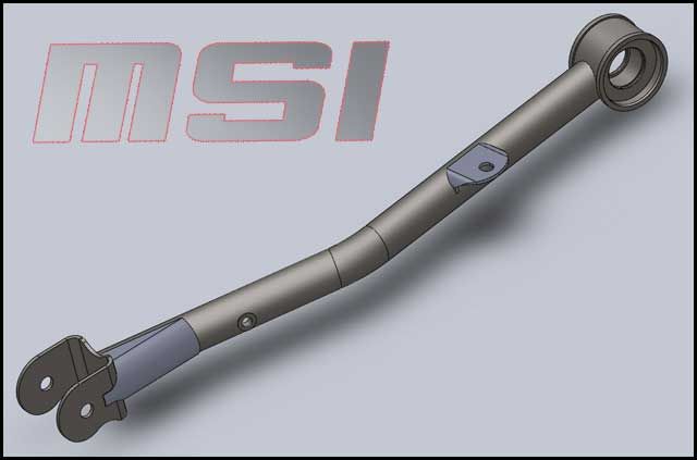

I wanted to give all of you a heads up on the latest developments we've been working on and perhaps gauge some interest so MSI and I can anticipate starting demand for the first couple of batches for these.
Over in the lateral link thread I started a long time ago there was questions of trailing arms and bushings. I hinted around, and for those that can't read between the lines yes it is something we've been working on.
So, we've been really busy, and I have a few things to show off, and get feedback on. There is one thing I will say about this thread. You will not see us or MSI posting pricing info here. It's a no-no to post any prices outside the for sale area. Any questions on price will go unanswered by us in this thread.
So, what we have up first is the trailing arm from MSI.
Here's some details on the arm:
  • Material is 4130
  • Body will be tubular meaning much stiffer than stock
  • There will be two arm length options
  • Option A is for the stock ride height folks or slightly lowered (lowered less than 1"). This arm is the stock length center to center of the bolt holes
  • Option B is a slightly shorter arm. This is intended for cars that are lowered 1" or more.
  • There are also going to be two big end (forward) end options
  • Option 1 is for the normal folks in that it will take a bushing. It is sized for a stock bushing which means you'll be able to use stock, group n, whiteline, powerflex, or ours (more on that in a sec)
  • Option 2 is for the race folks in that it's a spherical bearing.
Here is a pic to show you what I'm talking about. This one happens to show the front housing for the bearing end style. For the bushing end style take out that bit in the large loop.

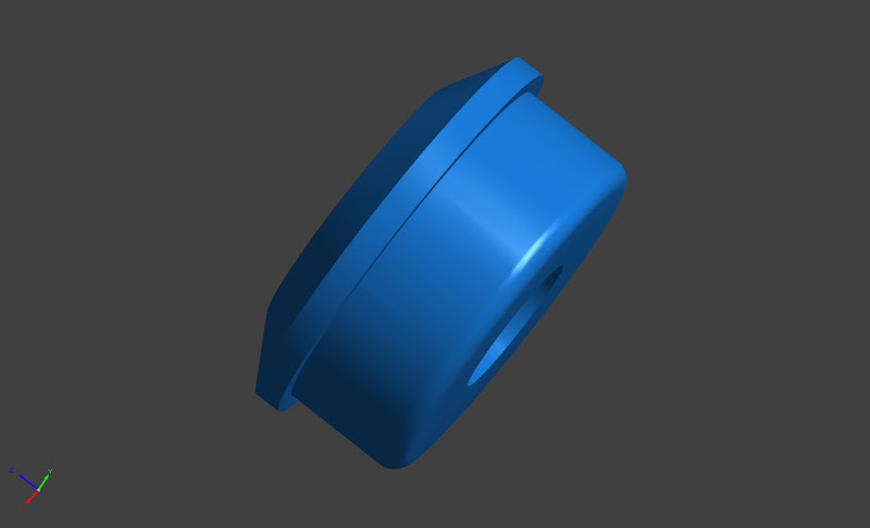

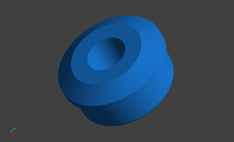

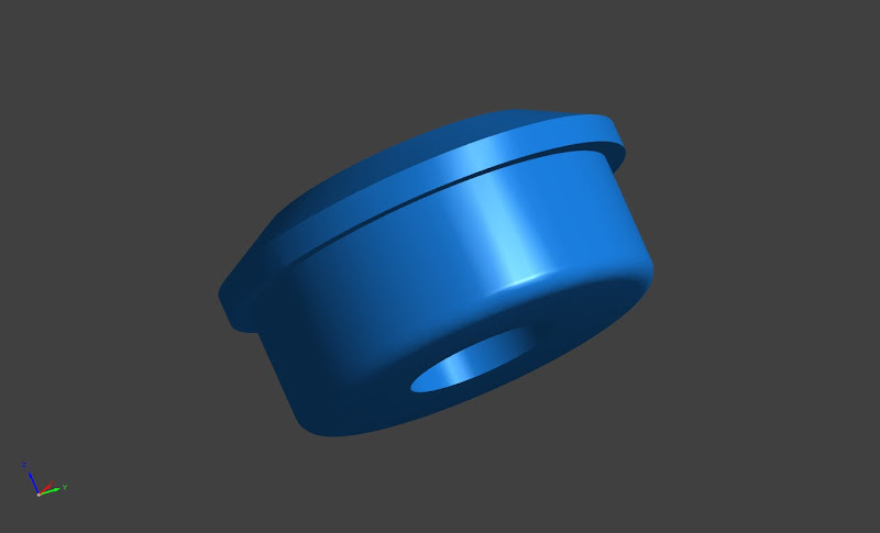

On to the bushings. As MSI has been working and sending me info for feedback we've been doing the same. It really has become a nice two way street on collaboration.
Many of the details are going to be just like the lateral link bushings we released not too long ago, but here they are for those of you who have not been following along.
  • Medical grade urethane (no heavy metals used as the catalyst)
  • Shore 95A stiffness
  • Graphite impregnated
  • Machined stainless steel crush tube
  • Split design for ease of install
  • Will not only fit the MSI arms pictured above, but will also fit the stock arms or any other arms that use a stock sized bushing in the same location
Here's a few pics of what we're looking at:

Last question first.
The ones made for stock/near stock levels are the same length as the stock arms. Thus, from a geometry standpoint nothing has changed vs. stock. At that point you're getting an arm that is stiffer than stock.
The ones made for a drop of 1" or more will pull the knuckle back into it's proper place so everything moves as originally intended in the arc centering around the inside points of the lateral links. Right now there's a bunch of cars (mine included) that are lowered this much, and as such are pushing the knuckle back and side loading the lateral link bushings leading to more static friction.
If you were to get the arm for a lowered car, and put it in a car that is not lowered the you are pulling things forward and again loading the bushings causing more static friction.
There's other things to this as well, but I haven't figured out a way to describe the pictures and motion in my head. I'll have to think about how to type that up so people understand.
Release date I am not sure on. It depends on a number of factors such as machine shop lead time and the like.
You know, very good point on that option. I need to add that...
Turn in Concepts is offline   Reply With Quote
