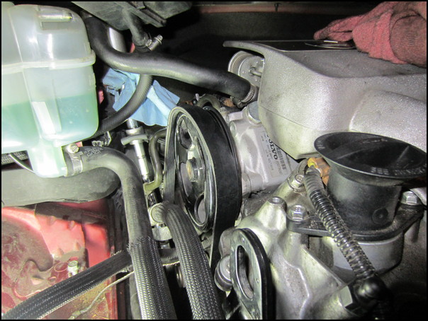

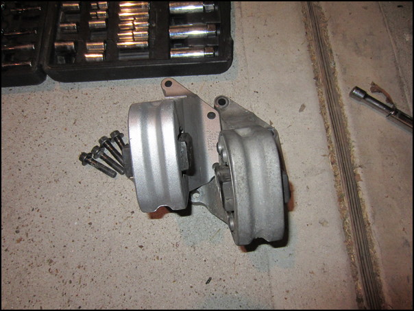

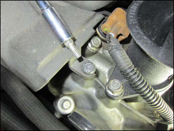

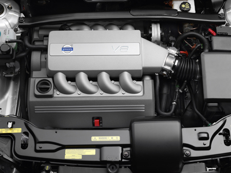

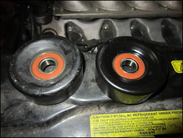

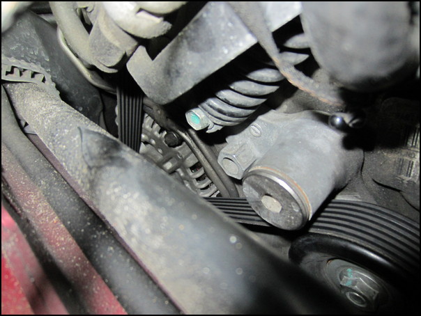

Car starts to make a weird growling noise that sounds like a power steering pump going bad...

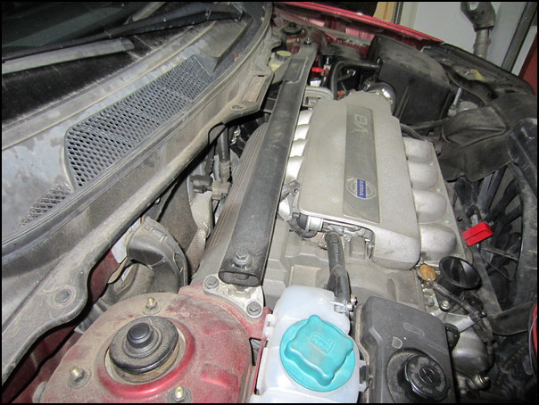

So, um, they managed to take a 4.4L V8 and cram it transverse-style into the engine bay of a Volvo designed to take an inline-5
Hmm, but it can't be that bad right? I mean, how hard can it be to change a belt and an idler pulley on a 100k mile Volvo with a V8 crammed in it sideways?

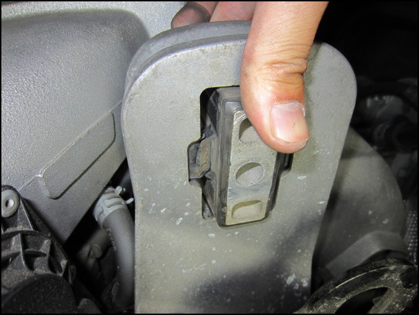

See that thing that looks like a strut bar? It's not a strut bar, it's the upper engine mount. Get that **** outta here.
****, the bushing in the upper engine mount is shot

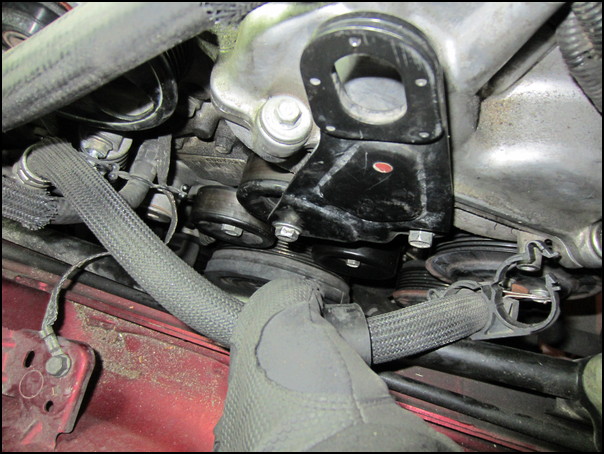

I ****ing hate these. They're everywhere to make it difficult to remove the plastic covers all over the engine.
This is the hellacious tensioner that needs 100 lb-ft of torque to compress. Fffuuuuuuuu
Ah, yeah, that's a bad idler pulley.
Old engine mount and new engine mount.
Old pulley, new pulley
Overnight parts from Japan
New idler pulley installed

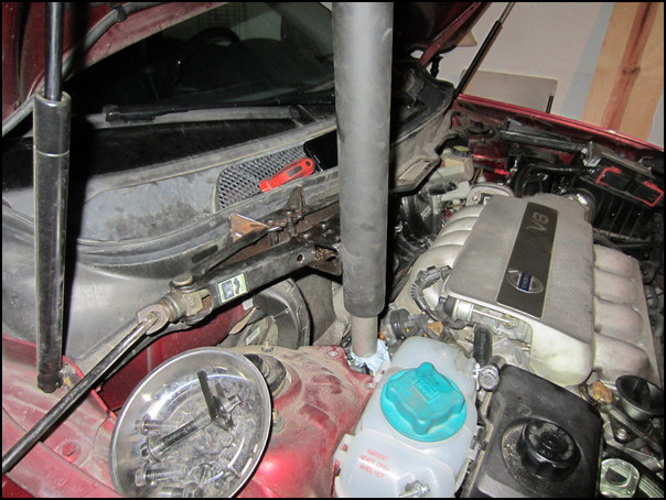

Cheater pipe...and scissor jack on the tensioner...so I can get the belt back on by myself. maybe. It still wasn't enough, and the tensioner was already max compressed...what to do?
atomicfire is offline   Reply With Quote

Redneck stretchbelt tool. Wrap a rag around the belt. Slip part of it over pulley. Stick screwdriver though pulley to force belt over it. Spin crank with socket wrench to finish pulling the rest of the belt over.
Finally done.
