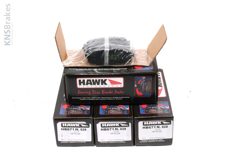

We just got the first four sets of rear HP+ that Hawk made for the BRZ
Are they any different than wrx pad shape? I thought they use the same caliper?

Rears on the BRZ are older Legacy pads, not WRX. Fronts are WRX.

BRZ
Front brakes = 2011 WRX
Rear Brakes = 2010 + LGT - hence new pad.
The FRS has two versions
The larger listed above and a smaller version
2011 Impreza front and 2011 Impreza/WRX rear
-Ken
