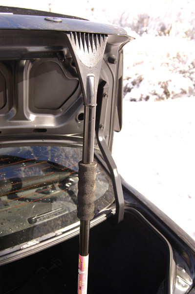

TRUNK SUPPORT - I used an ice scraper with a variable-length handle. You can also use a shower curtain rod. Something that can change length is best because it will be hard to find something of the perfect length, but anything that will hold the trunk COMPLETELY open will work. I originally tried to do this mod without this, and then the trunk hit my head as soon as I touched the first tension rod.

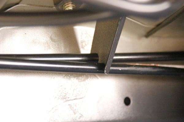

This is how the trunk rods work. There are two of them. One for each side. The rod uses the build-in energy of spring steel to push against the back of the car (back seat) and the arms of the trunk lid. By twisting the rod, the energy increases. So when the trunk lid is closed, there is the most tension. When the trunk lid is open, there is less tension. Hence, the trunk lid wants to open when the latch is released.

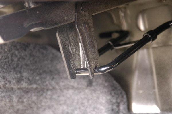

LEFT SIDE OF DRIVERS-SIDE TENSION ROD - Note, that this is the STI rod, already installed. It is glossy black. This pic is to show how the rod interfaces with the trunk lid arm. See the hinge-looking thing attached to the lid arm? That moves toward you and out of the way once the tension rod is pulled down and away from it. Also note that there is nothing holding the rod in place other than its own tension. Nothing to unscrew or unbolt.

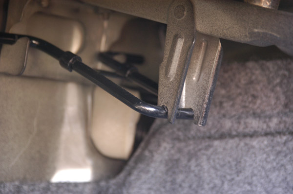

RIGHT SIDE OF PASSENGER-SIDE TENSION ROD DETAIL

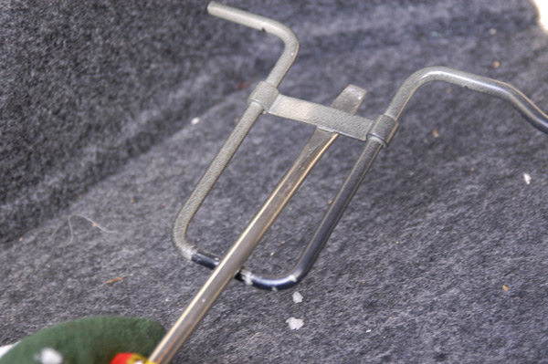

CROSS PIECE ON TRUNK ROD - Note how the cross piece helps facilitate the use of a screwdriver. Without this cross piece, this would be a MUCH more difficult mod to perform.

Step 2 - Brace the trunk on the right hand corner so that it will not move and so that the lid is open completely.

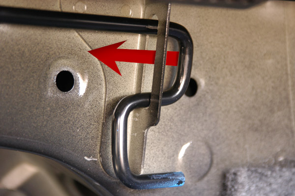

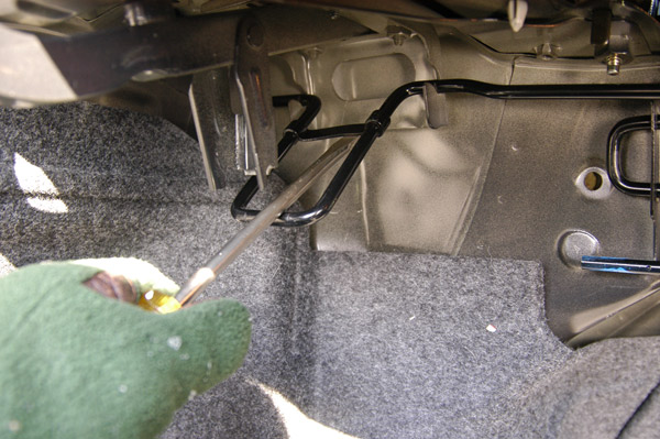

Step 3 - Start on the DRIVERS-SIDE tension rod. Place the long blade flat head screwdriver as shown bracing against the cross piece as shown in the previous picture. TENSION the tension rod at this position by bending the part of the rod facing you downward toward the ground as shown. Use your left hand to do this.
Step 4 - While keeping the rod tensioned, use your right hand to flip the hinged lid arm rod guide toward you and up until it is out of the way as shown.

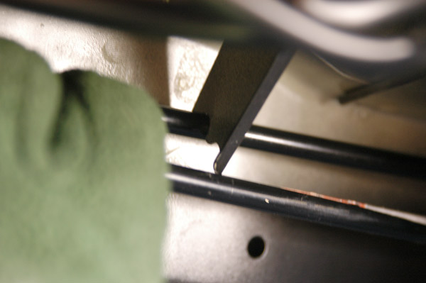

Step 5 - See how the rod has a keeper in the middle of the trunk:
Take out the one closest to you. Just pull it down and toward you slightly so it is out of its keeper. It isn't hard.

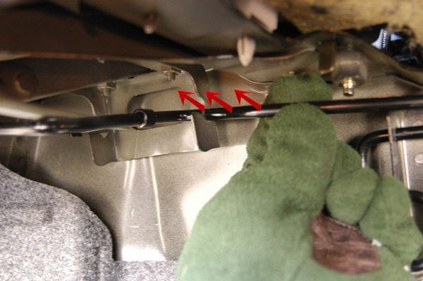

Step 6a - Now that the hinged guide is up and out of the way, release as much tension from the rod as possible by rotating the part of the rod facing you upward and toward the sky. Try not to let go of the rod. (If the rod slips off of the screwdriver, use the other screwdriver to get it back on.) Now, with a gloved hand, pull the back of the rod (the part furthest away from you) up and out of the hook as shown.
Even with the STI rod, this doesn't take that much strength to do.
Step 6b - CAUTION: At this point, if you release the rod completely off of the screwdriver and let go of it, it will pop out of its mount on the right and scare the heck out of you. It could possibly injure you if you are close to it, so keep your gloved hand on it and slowly lower the rod toward the trunk floor releasing the tension as you go (by rotating the end closest to you toward the sky).
Step 7 - The drivers-side rod can now be pulled out on the right:
REPEAT FOR THE PASSENGER-SIDE TENSION ROD. Make sure to move your trunk lid support to the left corner so it will be out of your way when working on the passenger-side rod.
