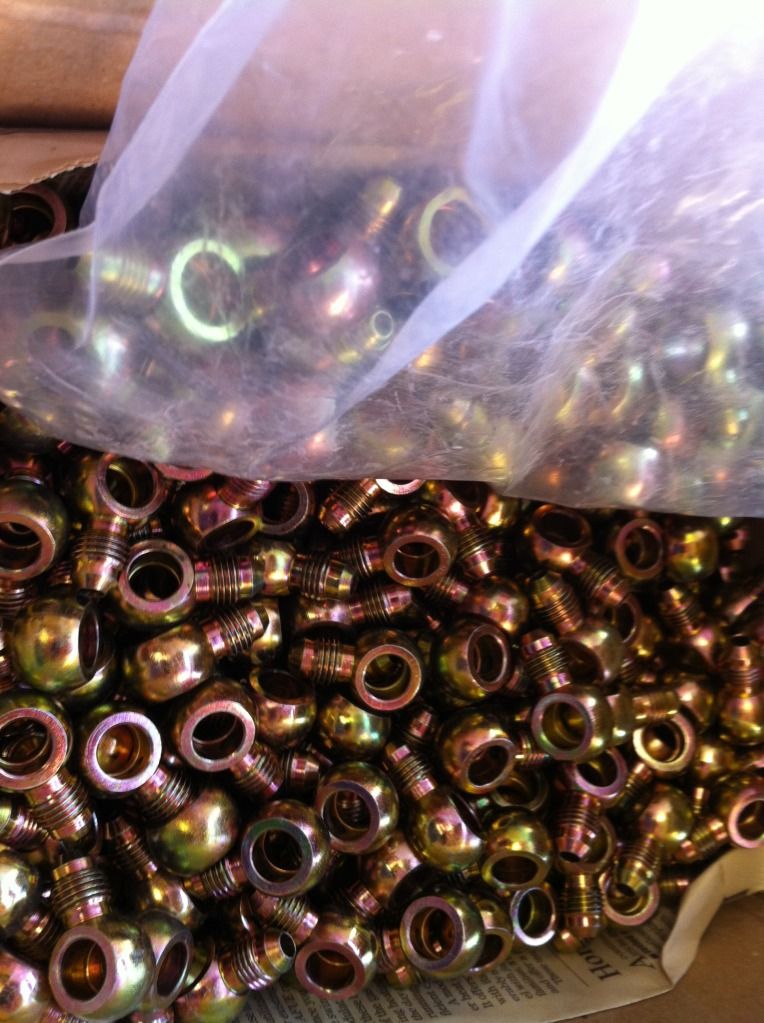

Originally Posted by nutinbuthehits View Post
im also trying to figure this out. i need a bango bolt an -3 fitting for the oil feed line on a gt3076r
Most oil supply lines are -4 an.
Banjo bolt is usually 10 x 1.5, 12 x 1.25, or 12 x 1.5. Most people who can help would need to know what size you need as there are way to many turbo's on the market many of us have not even seen.
The round part that goes on the banjo bolt is called a banjo adapter. It is the part that has the -4 male thread to go onto the SS line.
Banjo bolts:
Banjo adapters:
