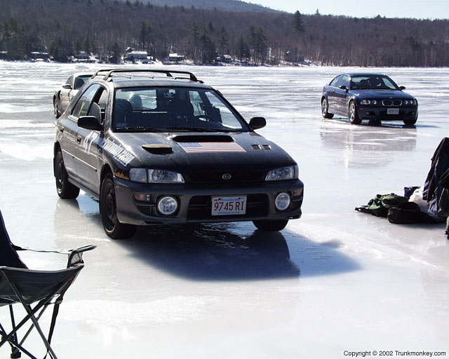

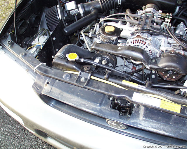

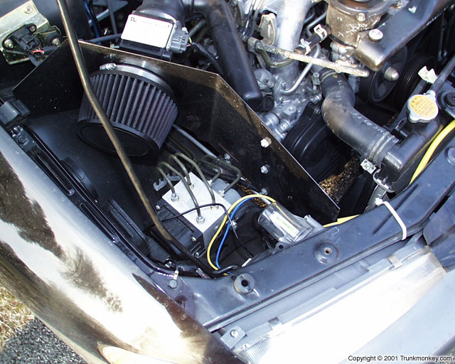

Turn3 R&D Cold-Air Intake Kit with MRT Performance Secondary Bonnet Scoop (http://www.mrtrally.com.au/). Stock exhaust. Great performance and sound. Make sure to seal around the edges of the secondary scoop or water will drip through the cracks directly onto the filter when it rains. No water gets sucked in when moving, even when pouring.
Here is the secondary scoop (replaces passenger side hood vent):
And the intake:
The remains of the silencer (the two empty tubes sticking out of the fender into the engine bay) have been removed and sealed over with metal heating tape to seal up the cold air box as much as possible.
