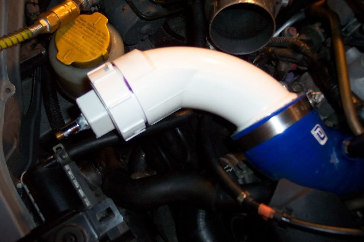

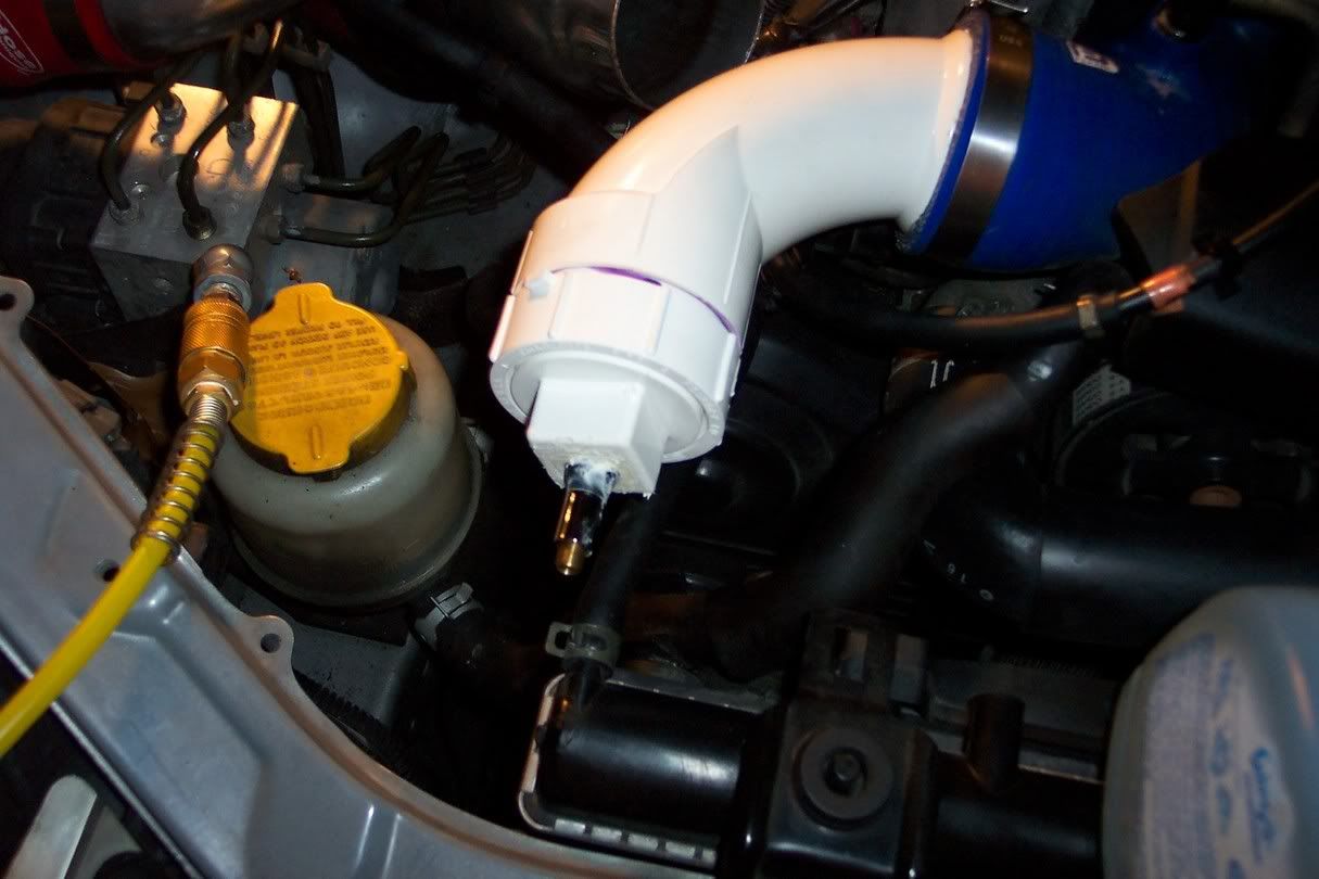

I followed Jorge (RiftsWRX) advice and built my own. Ran about 20psi into it and found 2 leaks. One at the throttle body and another in the inlet (vent hose). I fixed both leaks, but I would have never found them without this.
[IMG][/IMG]
[IMG][/IMG]
I thought this would have cleared up my stalling issues, but it did not. Thats another issue that I've been battling for several months now. Sorry these pics are gigantic.
