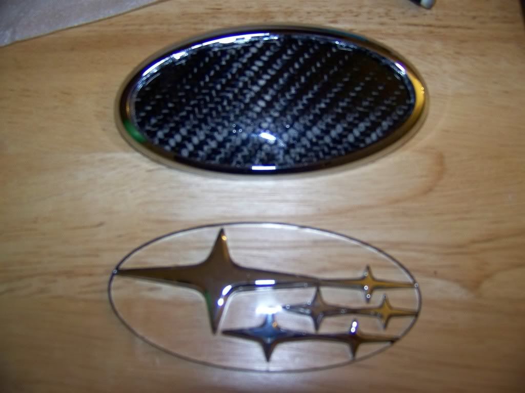

The 06 rear badge is like that. On my 06, the emblem back was completely covered with a thin layer of 3m VHB tape. From the view you're looking at in the pic, is there a small hole off to one side? If there is, use that to push the emblem off after you have heated it thoroughly with a hairdryer.
Here's my 06 in 2 pieces with CF on the chrome:
