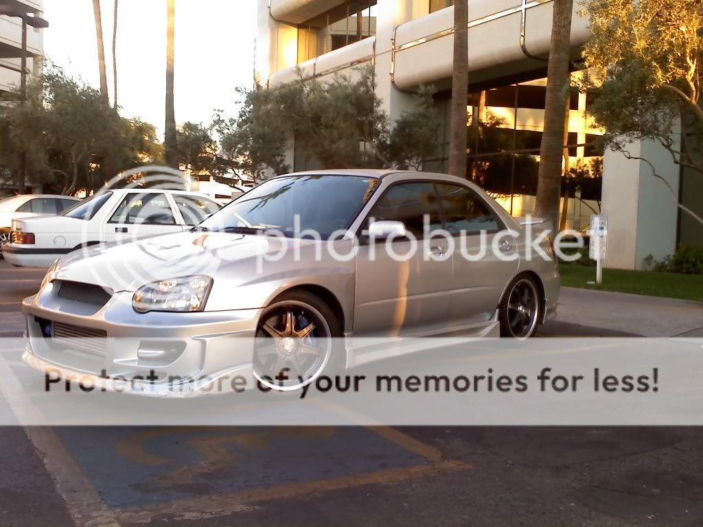

the beginning. August 2008. Bone stock engine. This picture shows the only thing that has remained with the car over the build - Charge Speed Version 1 Bumper...though its been repaired a bunch of times haha.
