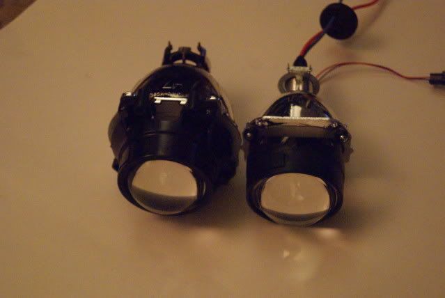

Halogen projector(the huge one) vs. Morimoto mini bi-xenon:

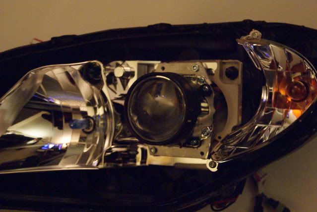

Test fit so only two bolts are shown:
