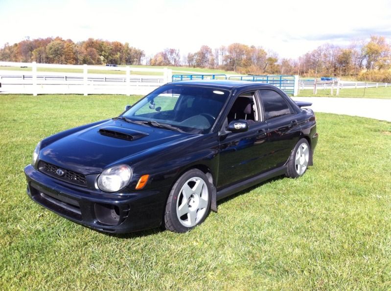

Quick update after the track. Dropped over a second off my time from the last time I was there. The star specs did great! My alignment was also pretty good for my setup with temps having a 10 degree spread across the tires. For reference to anyone else I ran (cold pressure) lf36, rf35, lr35 and rr34.5. This was Putnam park which has a lot of right hand turns and concrete. I still have at least another half second in driver error and I never changed rear swaybars setting which might have helped balance the car a bit more. Also my brakes started to get spongy the second day. I probably need better rear brakes to help out the front and also some brake ducting wouldn't hurt.
I'll post some footage tonight. Next month I'm going to road Atlanta to finish off the year. For now here is a pic of the new wheels in the daylight. The RS-3's did good but still need to be broken in a bit before I can really tell if they are faster. Definitely softer sidewalls but not really bad.
