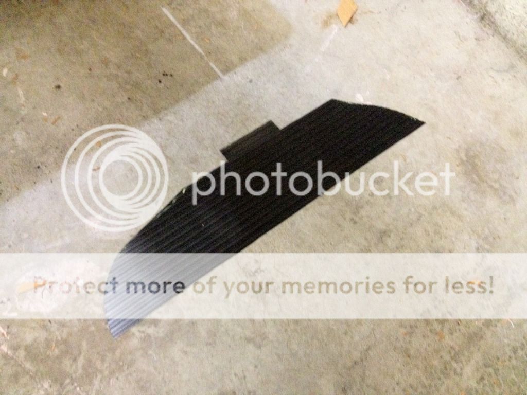

Take the strut tower scraps and cut out a 2 ridge tab right at the inside middle of each:

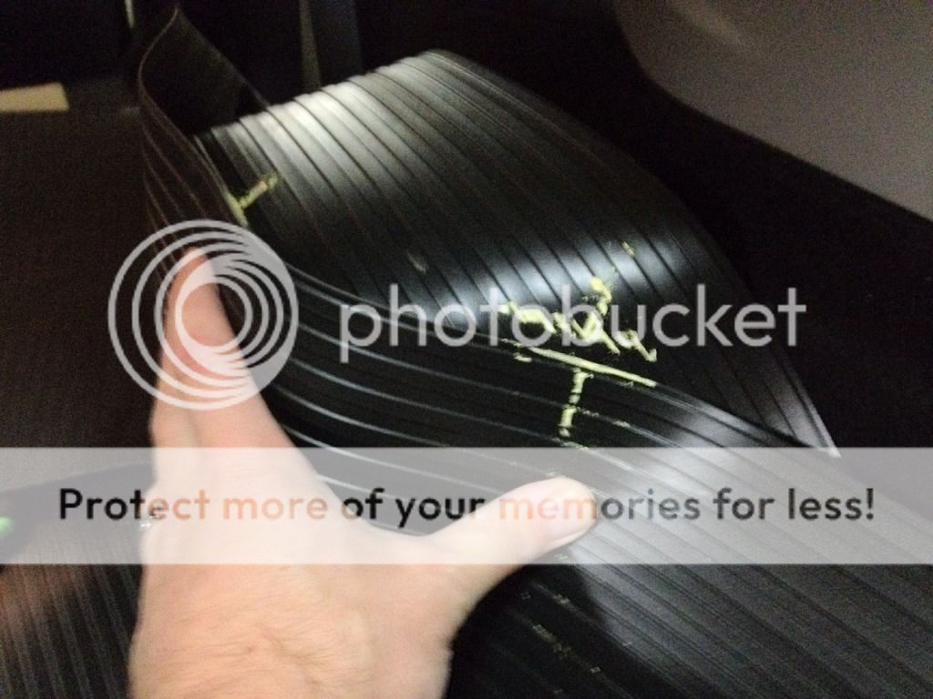

Start to shape the strut tower cover and sides to better fit the tower. Trim down the cover piece as needed so it doesn't make the sides stick out, then mark with chalk where the pieces should be joined for gluing:
The finished cover piece should look something like this:

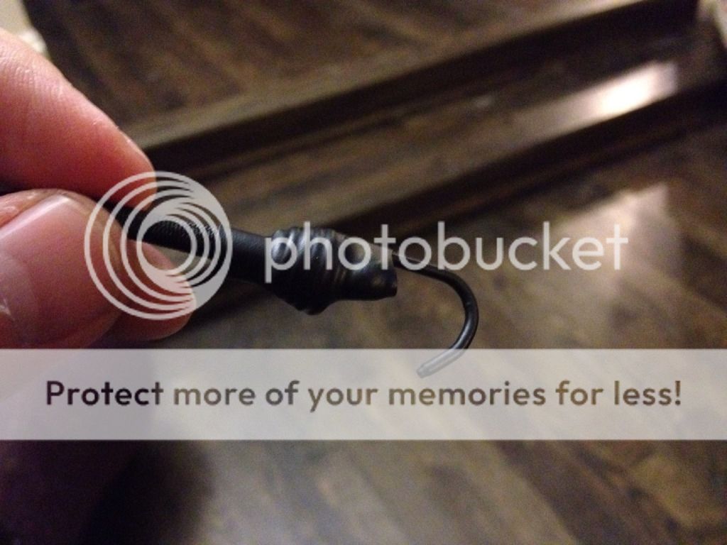

In the end I used the short bungee cords for securing to the headrests and the gear ties for securing flaps.*The flap design is really up to you, I cut flaps for the back of the hatch and both rear doors. The rear hatch door is the one that is truly necessary since the curve of the rear door makes the tub truly fit once you've cut out a flap, grommeted it and cinched it up. For getting the front of the tub to fit tight, I first shrink-tubed the *metal ends of the bungee cord:*
Next I simply clamped it down under the headrest, it stays here surprisingly well:*
