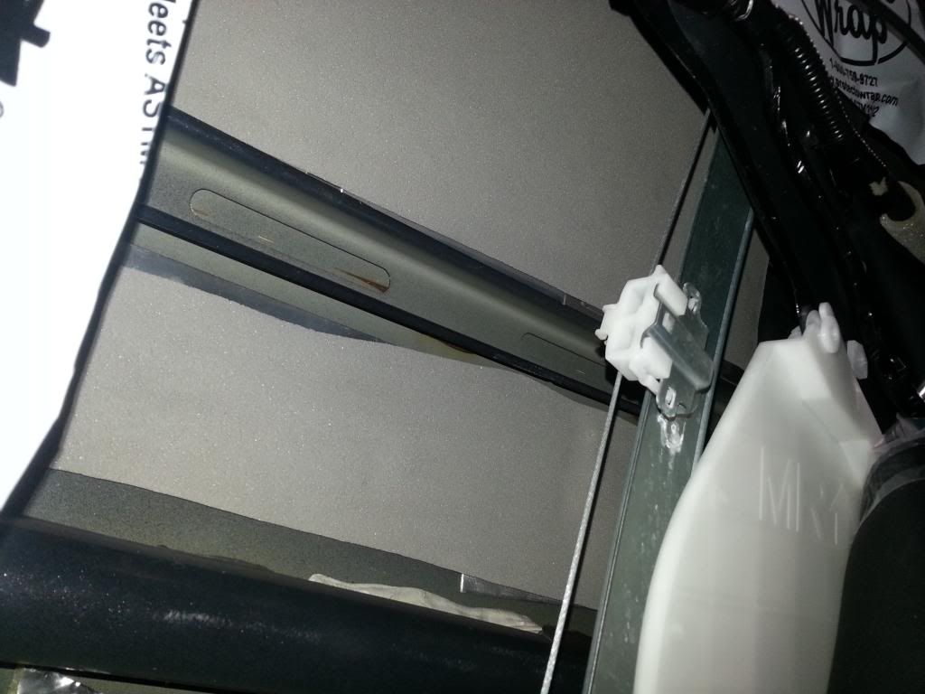

After that I applied the ADC to the door skin. This stuff is incredibly heavy and has a .020 thick aluminum backing.
After the ADC I added the foam backed aluminum on top. I only had about 4 sq ft of this so i used it as strategically as possible.
In order to reduce sound transmission in the door itself i added a layer of ensolite on top of everything using the spray adhesive.
