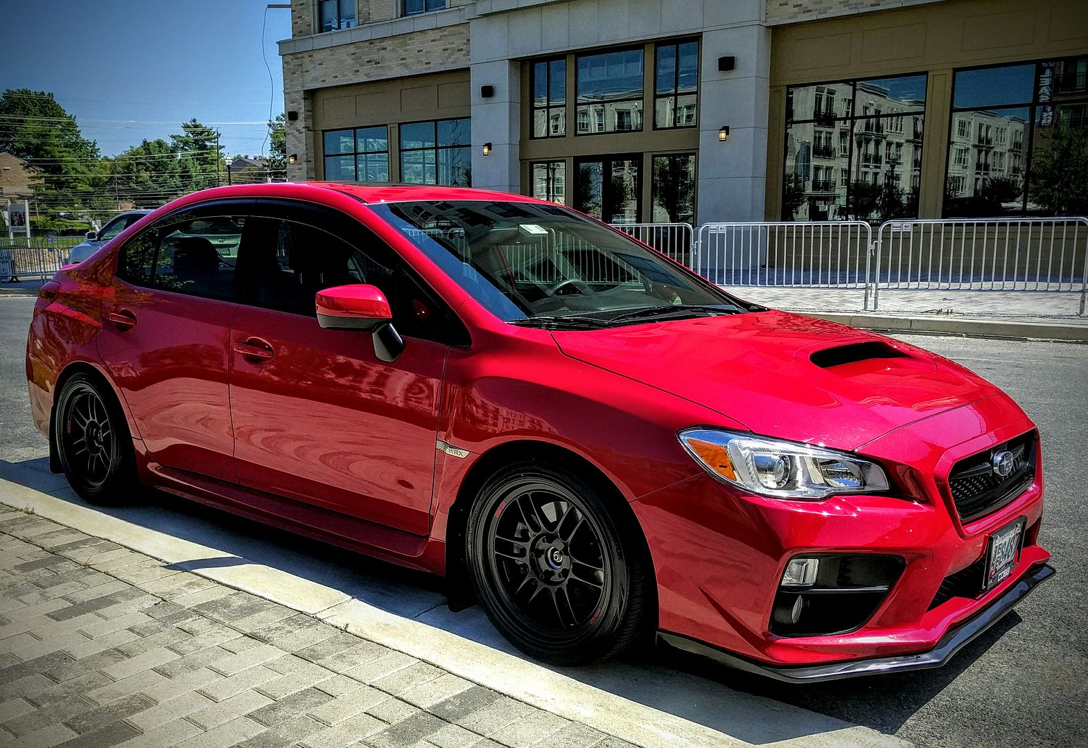

some quick cell phone photos after install of my set up this weekend. I'm sure springs will settle more... I will get proper photos up in a week or so.
1) ENKEI RPF1 18X9.5 +38
2) 255/35/18 TIRES
3) LOWERED ON RCE YELLOWS SPRINGS
4) FRONT CAMBER ALIGNED AT -1.4, NATURAL REAR CAMBER ( ~-1.9) (NO ADJUSABLE LCA)
5) DOES NOT RUB AT ALL. GREAT FITMENT FOR THIS CAR.
