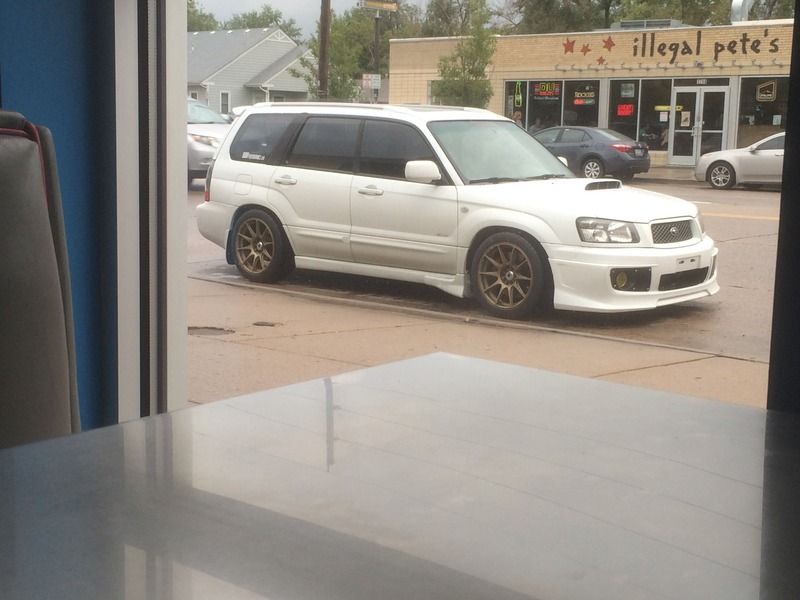

So, i originally had a 2004 fxt that i did a bunch of stuff to like sti swap, 20g front mount etc....
i ended up hitting a center barrier head on after hydroplaning and i ended up buying a car from a buddy and it had:

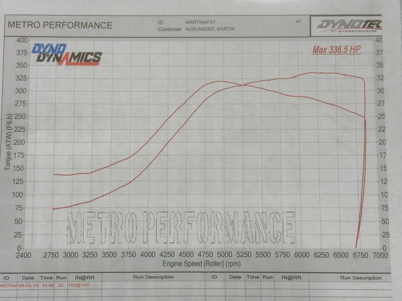

Car made 340/340 on 17lbs on 91
