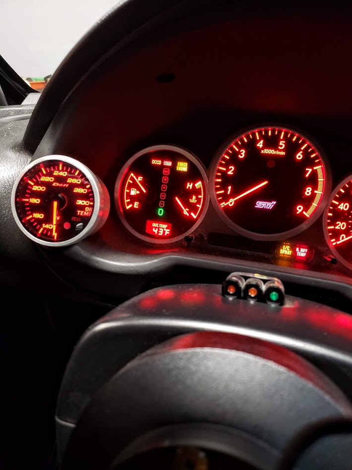

Having issues with fuel gauge displaying low fuel I managed to find a 05 Fozzy...
Pulled the floats out of it just in case mine were bad.
It was a bitch to pull it out but I got tired of not knowing how much fuel I have.
Tested the resistance and it fell withing specs..
For those interested this is how they read:
Left float:
Full 2.2 ohm
Empty 44 ohm
Right float:
Full 0.5 ohm
Empty 50 ohm
Both Fozzy and Sti floats read the same.
Pulling the passenger float is always a bitch...
I was about to switch them for ****s-and-giggles and noticed that the arm arrangement is different.
Since the pass fload read lower than the drivers with 1/2 tank I've bent the float arm a bit.. Figured with it laying in the garage for 3 years it might have gotten bent.
What do you know.. It magically started working.
Somehow I feel it was binding somewhere and after removing it and putting back it re-aligned.
Had a 5 gal jug and filled it up, while watching the gauge....
