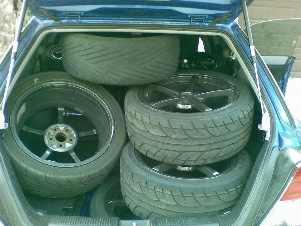

A few pics:
Wagon FTW! 12 wheels with tires:
