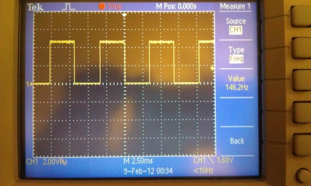

Originally Posted by toxin View Post
What's the voltage reading of the WDT should be?
Thanks.
Originally Posted by jkopinga View Post
Last but not least a test of the Watchdog Signal made with my Tektronix oscilloscope:
The voltage will vary between 0 and 5 volts, but you won't be able to read that on just a multimeter.
Also, I noticed the ECU layout is different than the 04 and 05 STI ECU's that I have unbricked. Could you take a high resolution of the test pad side of it?
