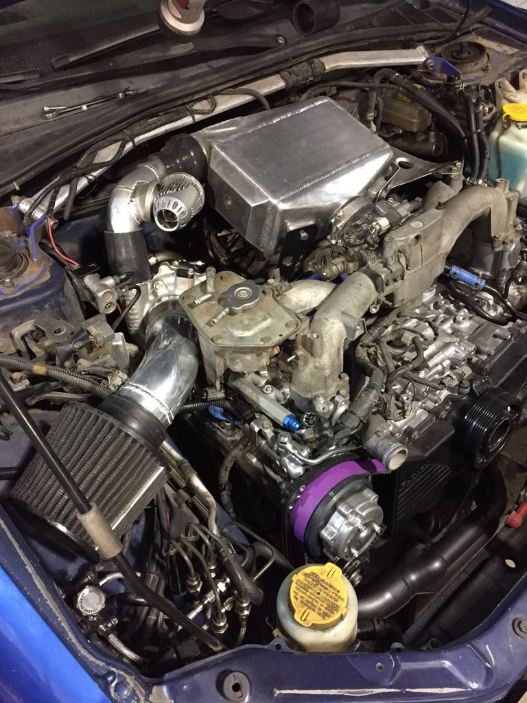

About the A2W, I have been running a frozenboost Type 14 intercooler in the stock intercooler location in conjunction with a Type 100 heat exchanger mounted where my AC condenser used to be. It's been a pretty solid setup.
It fits after I trimmed about 0.5 inches off the discharge so it would clear my strut tower brace, the heat exchanger fit after I cut off the neck and welded up the hole. I have used it at about 280 whp in autocross for about 1.5 years and never had any heat soak issues.
My own G25 build isn't done yet, but the turbo/intercooler system is. pics attached for some ideas. In order to handle the extra hp I have added a 3.5 quart reservoir in the trunk.
