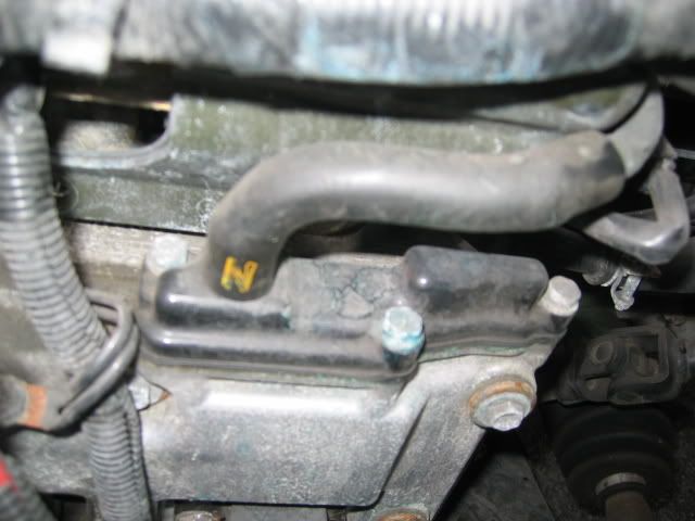

You will have to take this breather cover off in order to reach a 12mm bolt that hold driver's side GBOD.
Removed!

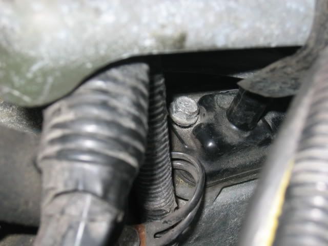

You can reach from the top to unbolt this hard to reach 10mm bolt on breather cover.

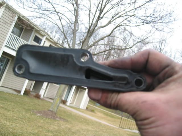

You will have to put this piece back on as hose off of breather cover is connected to a hose on GBOD. You have an option to cut this section off of GBOD and install it back on. I decided to put the bracket back on.
