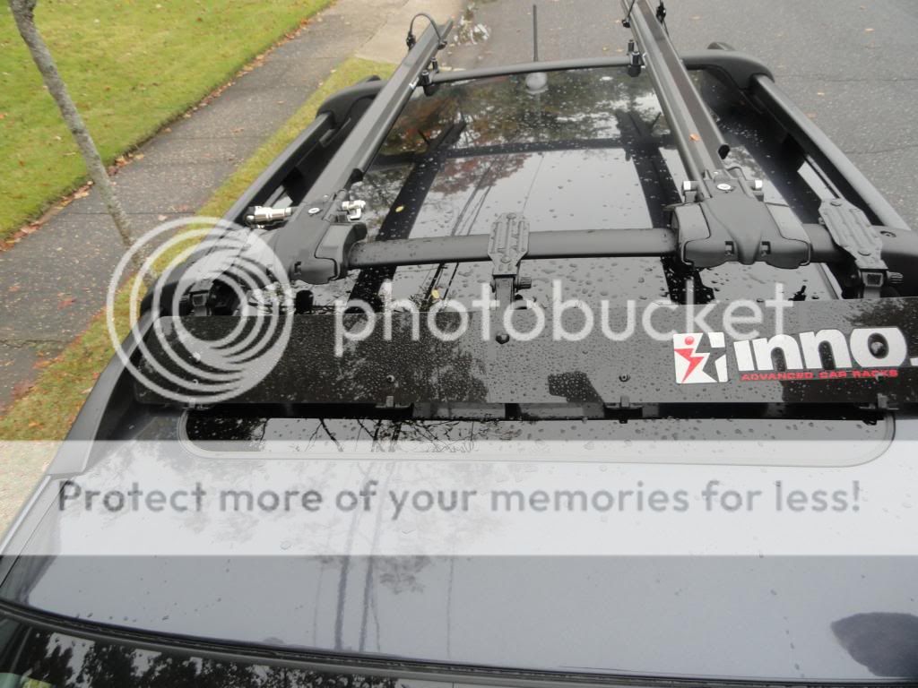

kylepreza, do you mind posting more overhead shots of the fairing? I just got my Impreza Sport and I added the Factory Aero blades (like you have) and I'm planning to add the Inno fairing but I have a sunroof and I would like to know the level of interference the Fairing will have with the sunroof.
Thanks in advance.
Hey, I have a sunroof as well. The set up isn't perfect:
(apologies for crap weather)
as far as I know the Inno fairing is the only one that fits factory aerobars, so I had little choice.
