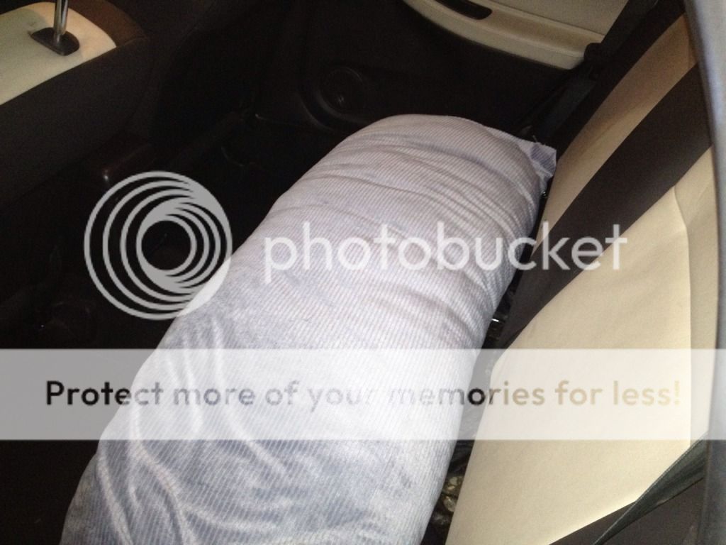

If you put anything of significant weight on the seat back, get a couple of body pillows for protection and resistance:
