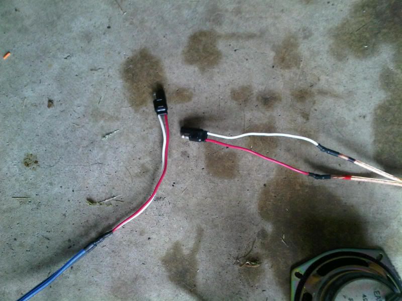

Finally got this installed (see amp wiring and install below). To make it easier and safer to remove at the track, I had to come up with something that allowed me to take it out without having wires all over the place. The enclosure is fiberglass, so there is no terminal cup on it- just wires passing through the "bowl" of the enclosure and sealed up with caulk.
To make a disconnect, I used a 2-pin trailer connector. It was about $2 at an auto parts store. I may come up with something better down the road, but for now it works.

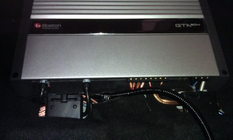

Finally installed the GTA-504 this weekend. Took a couple of afternoons working slowly, but it is done and all is working fine. 2 channels run the front components and the rear is bridged to the custom subwoofer inside the spare tire.
First off, the final install picture as it sits under the driver's seat:
All wires are tucked away.
Signal cabling is a Monster Cable 4-channel XLN that is a little too long, but excess was minimal. It runs down the length of the center console and is tucked in under the carpet to run to the amp's 4ch inputs. The remote turn-on lead follows the same path.

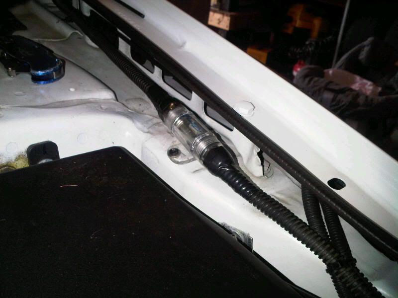

Power comes via 8 gauge Knu cable from the battery terminal, under the battery and then up to the fender (where it is fused), then behind the fender liner and into the driver's side kick panel. From there, it goes down the stock cable channel and runs under the carpet to the amp.
Fuse location:

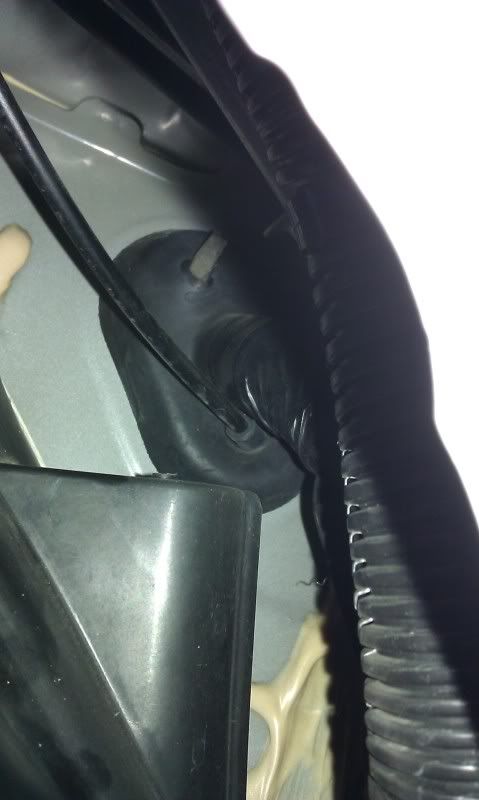

Gromet behind fender liner:

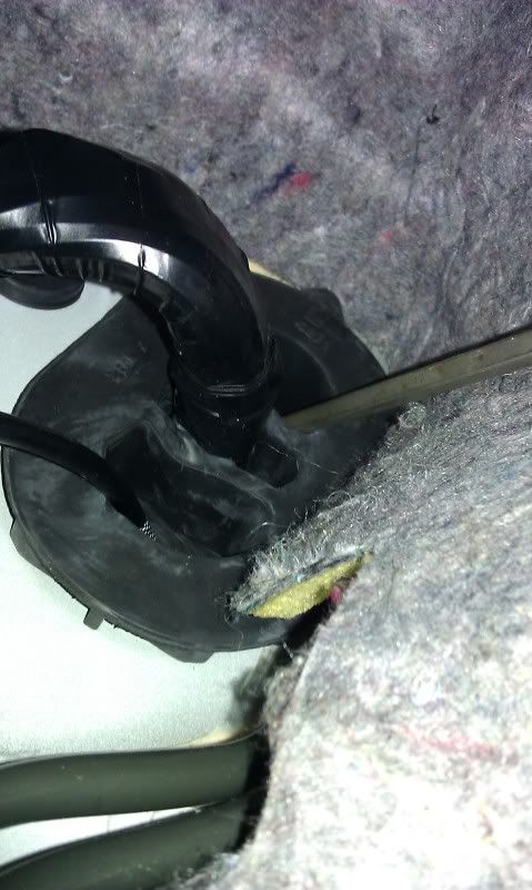

Same Gromet from the inside, carefully pierced with a screwdriver:

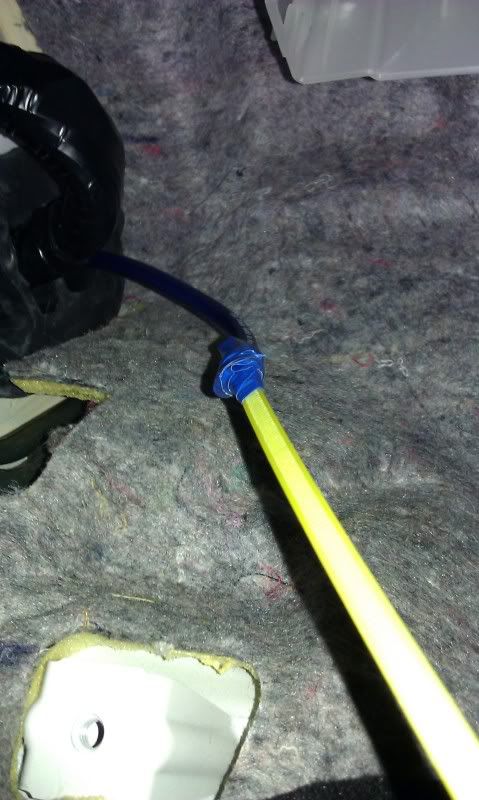

I passed the ziptie through the gromet and secured the wire to the ziptie to pull it into the passenger compartment. Here is the power wire taped to a ziptie, then doubled over to secure it for passage through the grommet:
Pulled through the grommet from the inside:

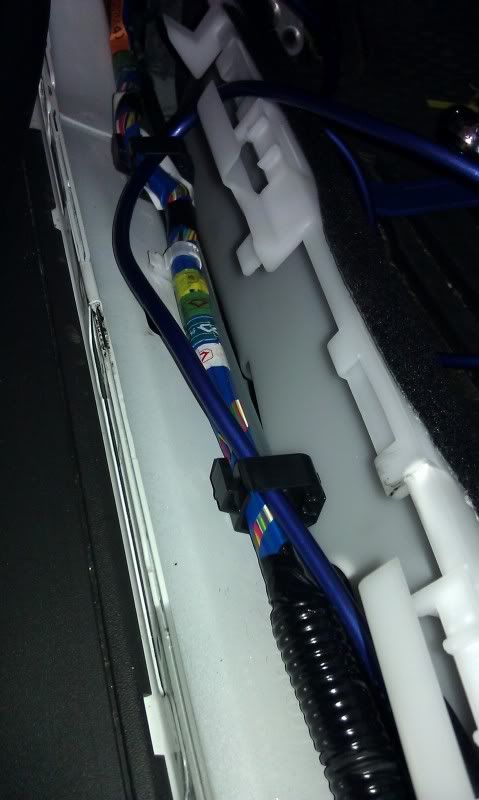

Down the OEM channel (it was pulled tight before being closed up):

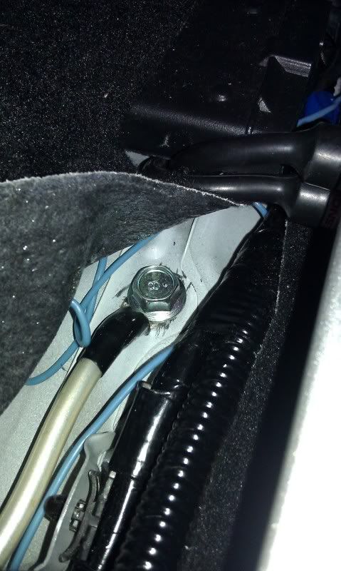

For grounding, I used this bolt near the OEM underseat vents. I scored the paint off of the metal and re-used the OEM bolt. At first, I had concerns over the solidity of the mounting point, but it gave adequate conduction.

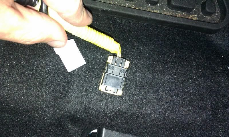

By the way, when removing the seat, you have to detach these 2 plugs.
One is a press-clip, while the other is a slide clip. I removed all 4 seat bolts, rocked the seat forward, and disconnected them. Also, when I replaced the seat I flipped the plastic piece that holds these two and located it above the metal bracket. Just squeeze the wings on the clip, remove it, and relocate it above the bracket. It is hard to describe but will make perfect sense as soon as you look under the seat.
