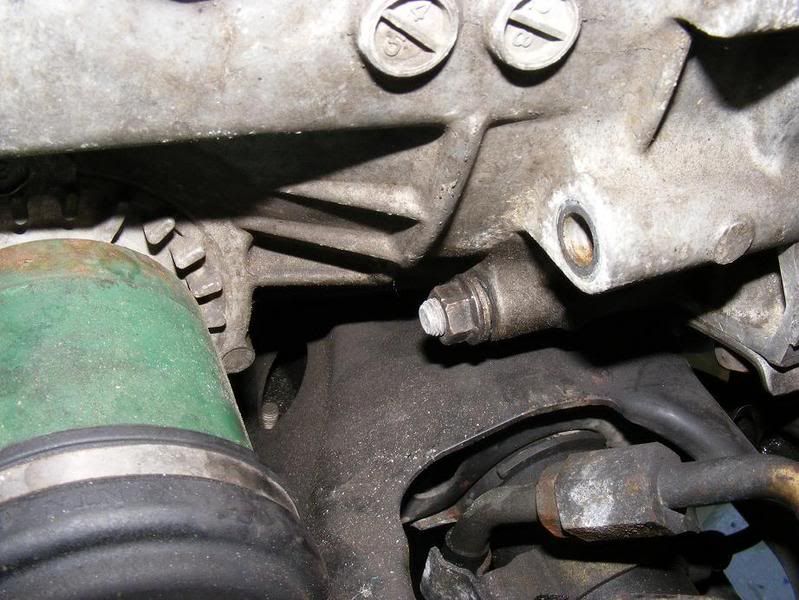

Originally Posted by beavis820 View Post
9. Remove starter
I already had 1 bolt out so the top bolt that is sticking out had a ground on it.
There is a 1 wire plug and a big wire on a stud like the alternator.
10. Remove turbo. Straight forward when you have a UR GT35R. Comes out on the uppipe.
11. Transmission bolts. Theres a bunch don't miss any.
And a nut WAY down on both sides.
No pic on the drivers side but it's there.
Pitch stop has to be unbolted in the front
12. Disconnect clutch fork from throwout bearing.
10mm hex
Thread something in. I use 1 of the battery tie downs (stolen idea from themadscientist)
OH MY GOD!!! thank you soooooo much, without this thread I never would have gotten my motor out, we were stuck for two days then I stumbled upon this tread and you saved our lifes. No one has said anything about the pin that hold the throw out fork. Yours was the only post that had it and it was the only problem. Thanks again.
