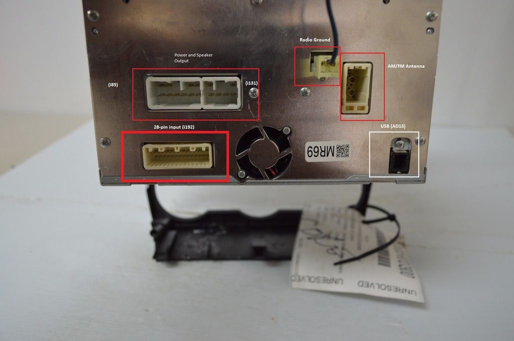

The following photo is of the stock 6.2" starlink radio on the base Impreza and XV for MY2015 and 2016 along with pinouts of each connector:
Best effort pinouts for i85 and i131 connectors. I'm not 100% sure if these pinouts are on the unit side or the harness plug. Best guess is that these are how the pins are if you are looking at the unit side.
