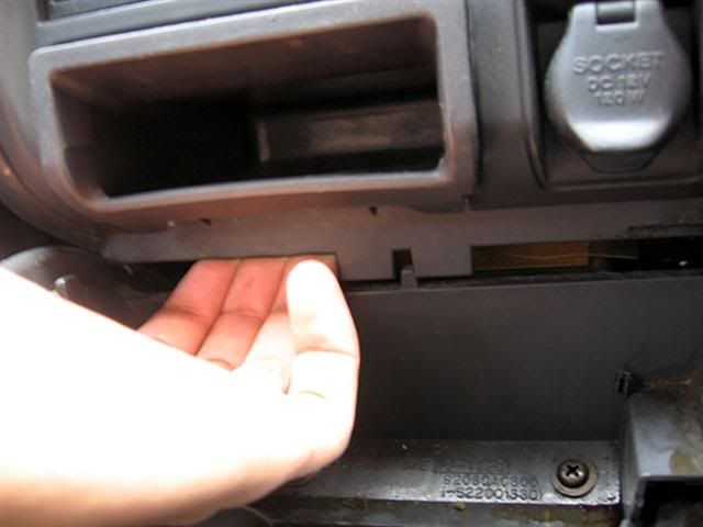

~this piece next to the cig lighter should come off by pulling the big trim piece from the bottom like in the picture
