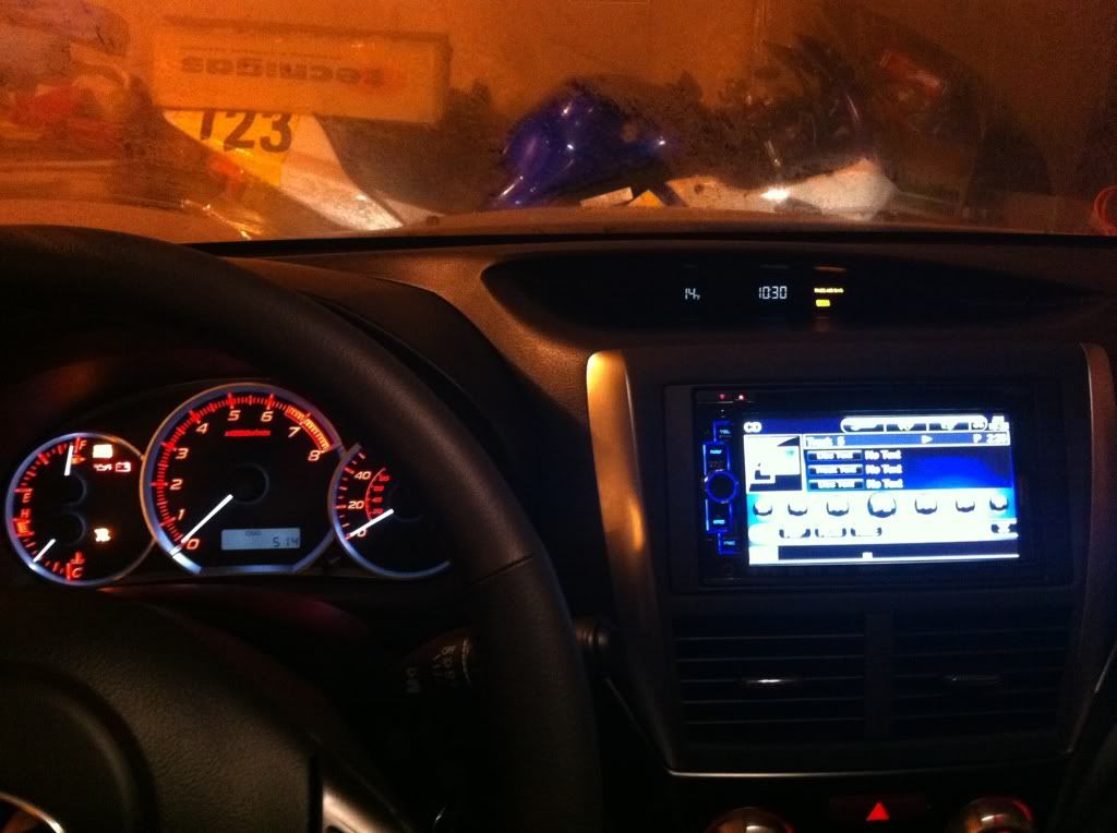

Threw in the Kenwood head unit with built in Garmin GPS yesterday, along with a pioneer amp and sub. Pretty straight forward.

Nice. What install kit did you use. looks real clean.

It was a Scosche kit.

Looks good, hows it sound?

The head unit by itself sounds loads better than stock HU. It is a lot cleaner. The 8" sub makes it sound even better and gives a really balanced sound.

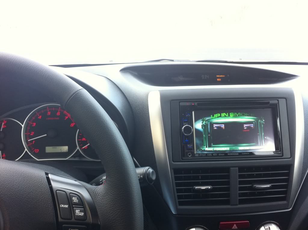

Looks clean. Can you change the lighting color scheme (red)?

Yes..
