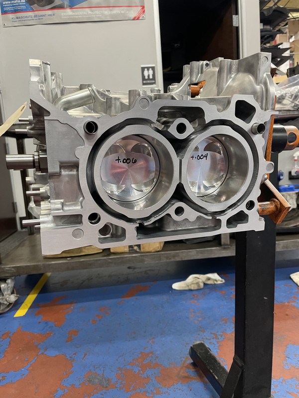

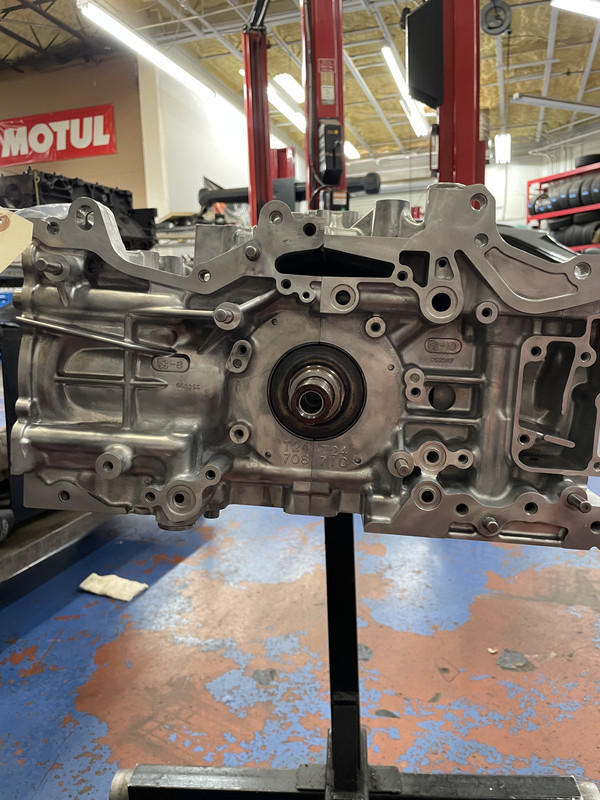

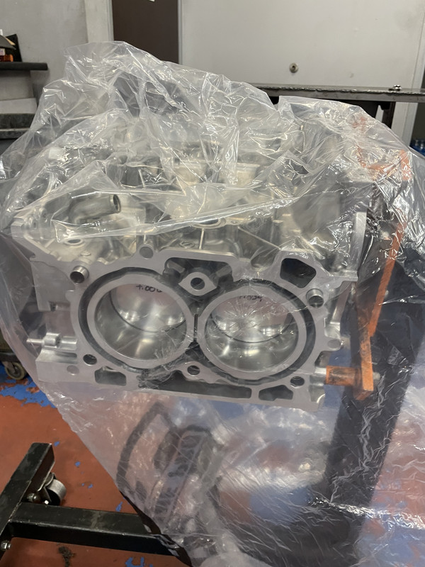

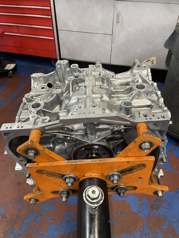

They been making them for a while, Outfront and P2P and Rallispec. But you dont need to buy a staged block, i built my own through Outfront.
Rallispec has a lot of knowledge, by the way and WILLING to share it. They sell front helical LSD and center viscous 12kg and 20kg. Also have transfer gears as well as fd 4.44s. Plus a ton of knowledge, them and Flatirons Tuning. They have a staged block too. I was impressed with their REAL performance upgrades, none of this mamby-pamby fluff you find on other retailers GUI websites.
At this point i am most likely adding a front LSD (plated or helical if it fits). Called them back today but was too late and they had closed shop. My car is at a local shop being assembled back and i feel taken care of by them too. There hasnt been anything that i throw at them w this new platform that they cant handle. GoodSpeed Performance is the name i would highly recommend. Its the only really ready and able to take it on at the time and do what i wanted, not what they usually do.

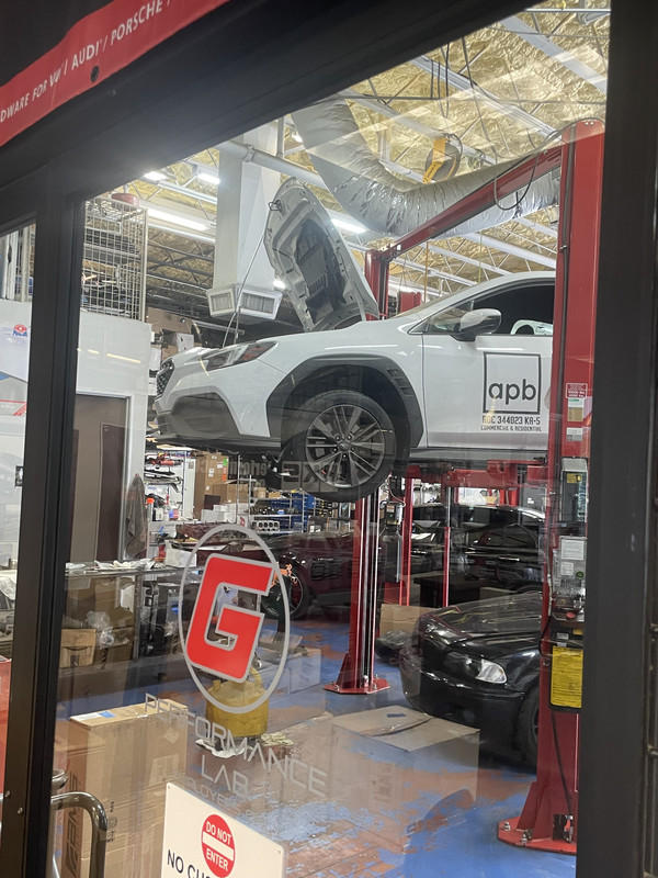

This is my daily so no rules apply. If allowed id drop ship a used r167 to ZF Design for LSD install of your choice, Torsen, AP Racing (also helical), or plated by Cusco. They can tune them for you to fit your driving style for a whole 1$ more if you buy LSD from them. ZF Design is the best shop as far as transmission and lsd work goes, they also may machine motors and more but dont assemble them as far as i can tell. I got recommended to them by 2 local shops and chit chatted with owner Zach for about 20-25 mins.
Metroperformance of Socal also should get mentioned for taking 15min of their time to discuss STi swap into VB.
But it boils down to me not wanting an STi driveline, and wanting to stay with WRX driveline, shifting mechanism and gearing, though if car survives tuning and making the power then i will ship to ZF Design to re-gear and possibly even convert to a 4.44 fd setup
Motor, turbo and jpipe in. Rest being finished this week or next week, so coming to a town near you soon...
