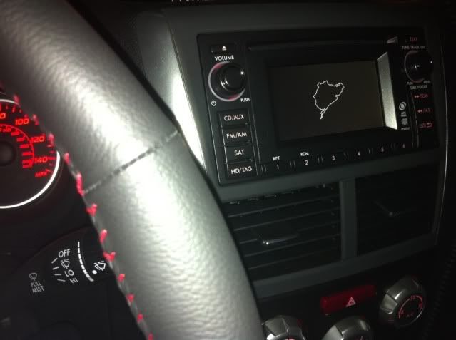

So, when I picked up my '11 WRX I was happy w/ the radio system (BT, USB, Sirius) but I was jealous when I saw the 2011 Forester high end radio was a 4.5" LCD. So, I set out to find one and was lucky to score one!
USPS dropped it off today and I got to "installing" which is a light term considering I just yanked out the old one and plugged this in. LOL
I retained 100% functionality of all previous functions. In addition to the obvious 4.5" display, the radio also had HD Radio built in, and I might add works quite well.
This unit also has an input for a rearview camera (on the way...) and another port that would handle a subwoofer input.
Anyway, on to the pics! I snagged a pic of each unique screen. What's also interesting is that in one of the setting directories is the change the background and screen saver. I'll have to do a bit more research on that.

Hm, my "butt dyno" of audio thought it did - but who knows. It did seem that I was a number or two higher on the volume than the previous unit, but that could just be a difference in calibration of the scale.
So, tooled around online and found the manual. I learned how to upload a screen saver. If you don't touch some select radio controls for 30 seconds the screen saver will come up. You have your choice of two in the system settings. Very easy to upload. Just dump a JPG on a USB Drive and upload.
I just picked a couple quick ones to try out.
Ah, another feature I left out earlier. You can see the HD/TAG button above.
1. HD Radio is streamed like digital cable. So, if you look @ my image in earlier posts you see 102.5 FM is selected. Well, about 3-5 seconds into the audio you hear a change over in quality. It's pretty dramatic. If you look up above where it says HD 1 2 3 etc. The 1 and 2 are highlighted. The technology allows this station to stream two digital 'channels' over 102.5FM. So, basically I can hit the HD button again and it will swap over to station #2.
2. The same button also has the tagging function. Let's say I hear a song I like I can press and hold HD/TAG and it will store the info of the song on my connected Apple device. I checked w/ both my ipod and iphone. Once you connect to iTunes all the data is there.
